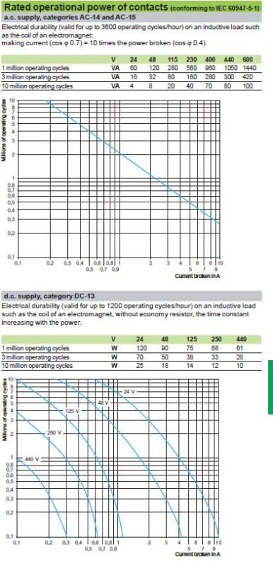

As a general rule, relays such as those will be rated for a minimum of 1 million electrical operations at rated load to a maximum of 10 million mechanical operations. How many years that comes out to depends on how often they are operated under load. So for instance if the relay is operated at rated load once per minute, 24hrs per day, 365 days per year, it will last about 2 years minimum. If it is operated 4 times per day 365/yr, it will likely disintegrate sometime after your grandchildren's grandchildren die.
Usually what will happen is that the contacts stopps working before it's mechanically broken depending on if it is DC or AC current you over the contacts, DC is worse ;-) and depending on the effect broken.
This is sheet is not for Siemens relays but I would say they are quite compatible.

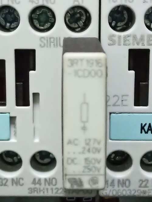

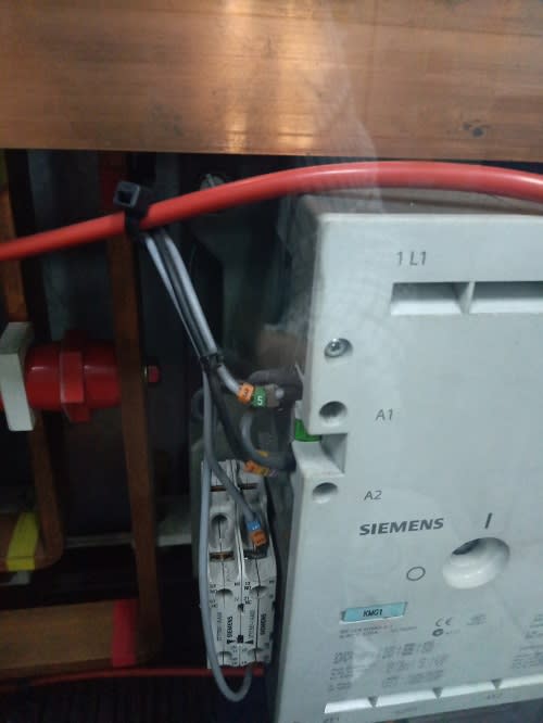

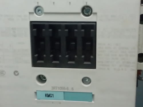

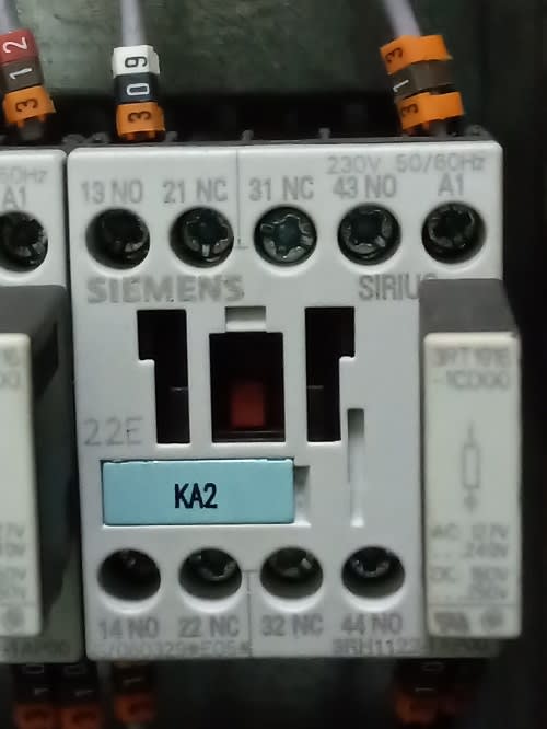

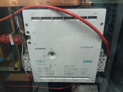

I have seen that there are RC surge arrester on the relay & contactor coils according to the wiring. Physically I can see the RC surge arrester on the 2 relays. However on the Motor Contactor I do not see the RC surge arrester.
Is the RC surge arrester integrated inside the contactor coil?
Plz see attached the wiring and some pictures.
Can you plz advise?
If there is no RC surge arrester on the contactor coil, the contact 13-14 on relay KA2 will be damaged soon?

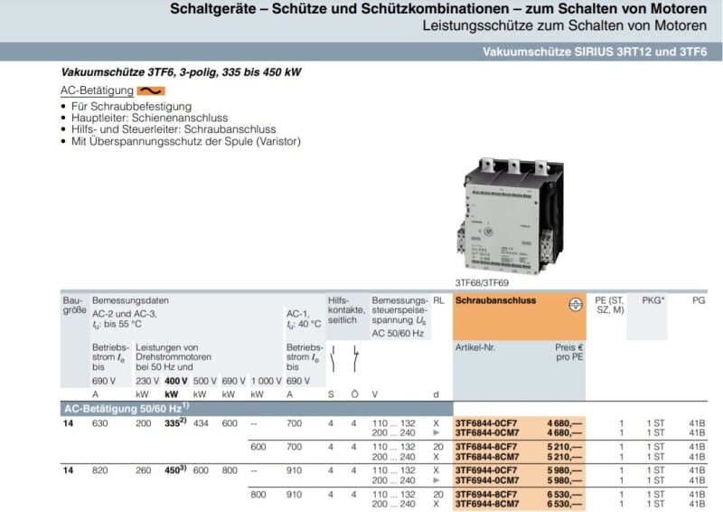

It has a built in varistor on the coil. (Mit Überspannungsschutz der Spule (Varistor))
1) When using the 3TF6 vacuum contactors in the vicinity of frequency converters, we recommend ordering a special variant:
3TF6 ...-....- Z A02.
The 3TF68 / 3TF69 vacuum contactors are included in the basic version integrated overvoltage damping of the main current paths.
When operated in circuits with z. B. DC converters, frequency converters, variable-speed drives, this wiring is not required.
The wiring can be damaged by the generated voltage peaks and harmonics and therefore lead to phase short circuits.
The contactors can therefore optionally be supplied without integrated overvoltage damping. Without extra charge.
Then add "–Z" and order code "A02" to the article number.
2) For the use of 3TF68 vacuum contactors with IE3 / IE4 motors 8.5 times the starting current, please use 3TF69 vacuum contactors.
For more information on design and project planning, see page 3/7. 3) Use of the 3TF69 vacuum contactors with IE3 / IE4 motors on request.
For accessories and spare parts, see pages 3/139 to 3/142

The 3TF contactors are vacuum contactors and the coils on them are DC to help avoid bouncing of the vacuum bottle contacts inside, so even if you order it as an AC controled version, there is a little circuit board that accepts the AC signal and converts it to DC to operate the coil. That has surge suppression built in.
Sorry I did not mention earlier that our power plant tripped following fault on the relay. We noticed several times after we started our FD fan on the boiler, it stopped. We replaced the relay and restarted the plant. After we replaced the relay, it was ok. We suspect the contact 13-14 on the relay is faulty.
Can the integrated varistor in the contactor coil be faulty? How can we test it? Can we add a second RC module (Siemens 3RT1916-1CD00) in parallel on the contact 13-14 of the relay as there is on the relays coil A1-A2?
We have 2 power plants identical and 15 motors with soft starter & bypass contactors similar as the FD fan. So this problem can happen again on any 14 other motors which are critical for the power plants and may cause a power plant trip.
The power plant was constructed in 2006. What do you advise us to do?
Should we replace all relays and all contactor coils to prevent such problem to occur again?
13-14 is a N/O contact. I had a similar problem on my VFD and a N/O contact on a timer used to stop my drive. The drive had been operating without any issue for 15 years. We found that the culprit was dirt and dust contamination. All solid state contacts, mostly used for the powering of the cooling fans, were cleaned with the use of a contact cleaner and we have been operating without any stoppage for more than 6 years now. You may also wish to use dust-tight design contact. I know that Eaton and Schneider used to make them.

First of, it hade been easier if you hade verified by measuring that it actually was a bad contact on 13-14.
Less guess work that way. ;-)
