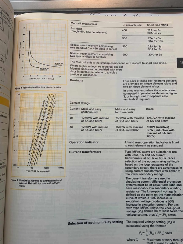

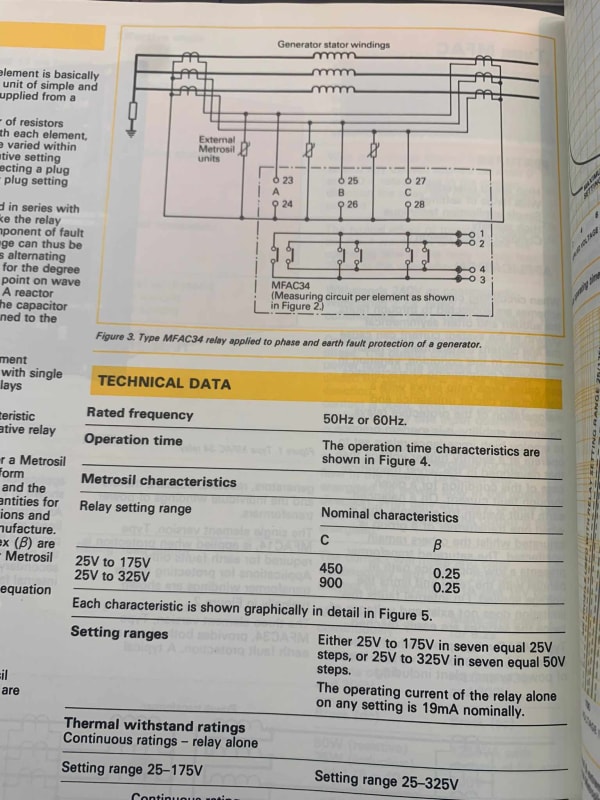

@ Mr kaspor (Electrical)(OP)18 Sep 24 11:32
Yes the MFAC. The manual for the MFAC talks about a stabilizing resistor and the standard sizes available but no literature on how to size it.
Please see attachment. Hope it is useful.
Che Kuan Yau (Singapore)
The metrosil size would be based on the maximum energy to be dissipated for an internal fault. Calculate that, then purchase the size metrosil.

In addition to my a earlier post dated 19th inst. 02:49, you may like to look into the publication "GEC protective relays application guide" page 262-3 which touch on "...by increasing the RR, the spill current can be below any specified relay setting... the series-connected resistor is the Stabilizing resistor ...."
