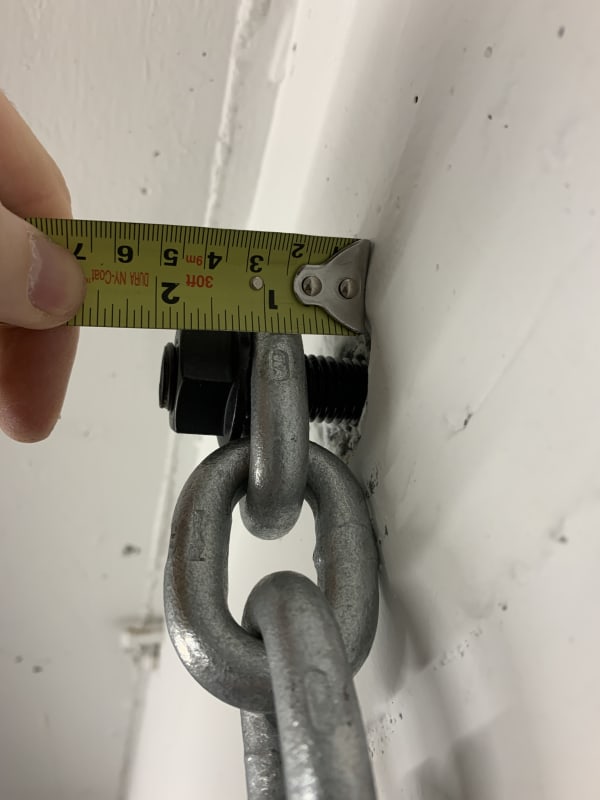

Hello, I work in a small R&D lab. Our CTO had our technician set up a lifting point using a concrete beam in the ceiling of our lab (a week when I was out). I would like to validate the strength of this setup to make sure it is safe, since it was done very ad-hoc.
The setup is a 3/4"-10 double threaded stud through an existing ~3/4" conduit sleeve in a concrete beam. The beam's dimensions are 12" in height and 12" in width. The sleeve is 8" from the bottom of the beam. The two ends of the stud are nutted + pinned, and are used to hang chain for a chainfall.
I have done a hand calculation for the stud (125 ksi min tensile strength) assuming two-point beam bending. Using a factor of safety of 5, I found it to have a 700 lb capacity (350 lb vertical load per side).
My question is: how can I validate the strength of the concrete / what should I consider for that analysis? I do not have a lot of experience with concrete analysis, so I would appreciate any insight or references. I do not have access to any of the building plans or technical information. I would also appreciate feedback if it is a bad idea to even try to do a validation for this - I am just trying to do due diligence one way or the other.
Some folks in the office already lifted 600 lb with the setup (again, I was not involved when they did). If we do decide on an actual load capacity, we will test it at 125%.

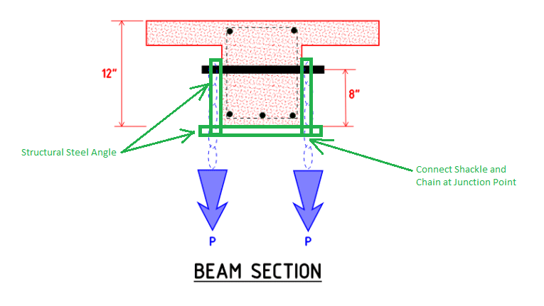

So the setup looks something like the following?
If so, and assuming the span is not excessive, applied load is relatively small in magnitude and short-term only, then you probably do not need to consider span-type 'global' effects.
You need to check the 'local' concrete failure modes like direct-tension pullout of the existing conduit (possibly a form tie hole?) with through-bolt/stud. Without knowing the existing rebar within the beam, you will either 1] have to assume an unreinforced section or 2} GPR span the beam and determine shear stirrup spacing and longitudinal rebar, and possibly probe the beam to check for rebar diameter.
For direct-tension, if you assumed a 45o failure-plane (actual will be be more like 35o to horizontal) that would give you a failure area of 1.414 *8" * 12" beam width x 2 sides = 271 in2. Assuming a concrete tensile strength of 200 psi (this would need to be verified and also check beam condition for existing concrete cracking in proximity to the connection) and that would give you a pullout strength of 54,000 lb.f
With a through-bolt at failure you will have curvature of the bolt/stud and local high-contact bearing stresses under the invert of the conduit/concrete way before 54 kips.
Seems you will be limited by bolt/stud capacity, or maybe chain capacity depending on the chain size/grade.

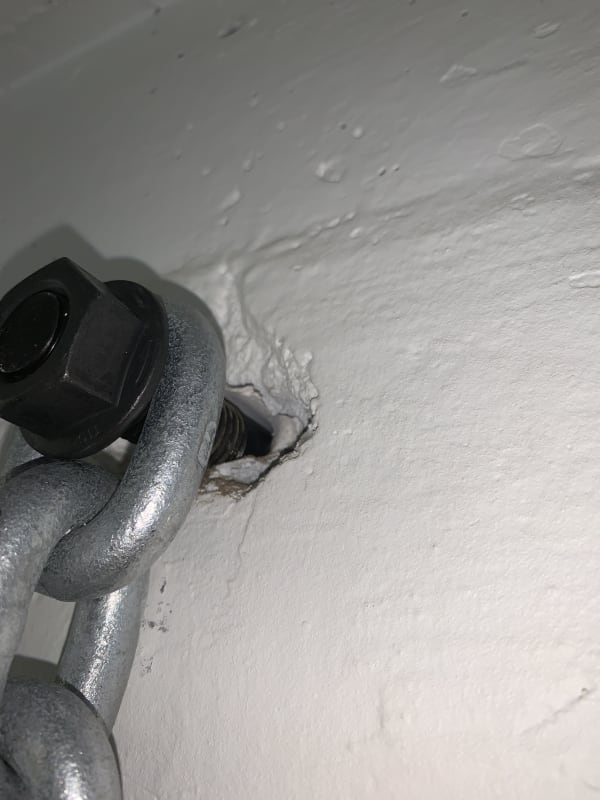

One more question - there are two lifting points that have been set up. The concrete condition in the first is very good, no indications. In the second, near the form ties, there is some missing material (much of which has been painted, so it has been that way for some time). This is more of a basic statics question: for static loads, do irregularities in the surface "de-rate" the static capacity of the member, i.e. act as stress concentrations? As far as I can tell, there is no crack propagation through the bulk material. I know for structural steel, stress concentrations are less relevant, but I am wondering if it is more relevant for concrete as a brittle material.
Usually the hanger is a stirrup, this will fit close to the beam and minimize the bending of the bolt.
The bolts should be close fitting in the holes also. We used double ended studs so that the center portion was smooth, no bending of threads.
Then make sure that the hoist is small enough. Stencil the max lift on concrete and make it clear that they cannot use a larger hoist.
I'd probably use a BAR 1/4x3 and bend it so it slips over the beam just to minimise bending in the pin. Your advice to paint the capacity on the beam is excellent.
I agree that bending of the bolt is your main concern after seeing the photo. The localized spalling of the concrete around the exposed portion of the through-bolt is not so much an issue for the concrete beam as it effectively increases the "cantilever" length of the bolt as the point of fixity or fulcrum gets shifted back further into the web of the concrete beam thus increasing the stress on the bolt. You can eliminate or lessen the bending of the bolt and just rely on direct shear of the bolt by placing your bearing point as close to the face of the concrete beam web as possible. As dik mentioned, perhaps with some bar or angle iron.
Thank you STrctPono for the input. I agree with your concern. When I did my nominal stress analysis on the bolt, I assumed a cantilever length of 2" to be conservative, which I think is about 0.75" longer than the apparent length.
