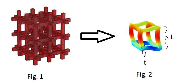

I exploit the symmetry of fig.1 to simplify it to fig.2. This figure has a volume fraction of 0.2, and I need to find a relation between t and L. Have I done it right?
Volume of cube in the middle: (L-2*t)^3
And 4 rectangular plates around the cube in the middle: t*(L-2*t)^2
Volume of fig 2 is then: L^3 – ((L-2*t)^3 + t*(L-2*t)^2)
So volume fraction is that volume divided by the unit cell cube volume, giving:
(L^3 – ((L-2*t)^3 + t*(L-2*t)^2))/L^3 = 0.2
Which gives the relation:
t = 0.0428787 L
Figure 2 is not a unit cell, in that you cannot stack those next to each other to produce figure 1.
The corners of the unit cell are in the center of where the rods intersect.
Also, your last equation cannot be close to correct because the relationship between t and L is not a constant. L and t can be any two numbers, as long as L>2t.

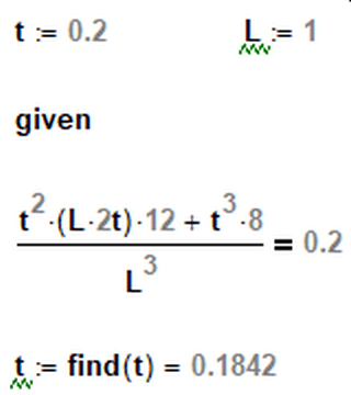

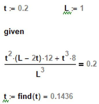

He's given a fixed volume fraction, though. Nevertheless, the final equation is wrong for another reason, namely, the numerator should only contain the volume associated with the beams. Something like below. There are 12 beams and 8 corner cubes
TTFN (ta ta for now)
"(L.2t)" should be (L-2t)
L is CL to CL and t is the width of an arm, and the arms are in the edges of the cube, then the empty central cube is (L-t)^3 ... t = 2*(t/2)
and there are 6 side (face) voids (L-t)^2*(t/2) ...
(L-t)^3+6*((L-t)^2*(t/2)) = 0.8*L^3

(if an arm is 2t wide, then t = 0.14357

"Volume of cube in the middle: (L-2*t)^3" ... no, if L is CL to CL then it's L-2(*(t/2) = (L-t)^3
"And 4" ... no, there are 6 (one at each face of the cube) ...
"rectangular plates around the cube in the middle: t*(L-2*t)^2" ... no, t/2*(L-t)^2
The unit cell would have the legs "t" being half the width of the full structure's, I think, since one would slice the structure right down middle of the width of each full sized leg
