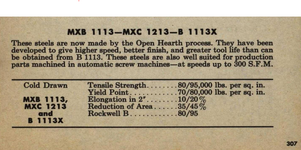

Hi All,
I am unsure exactly what the drawing is stating here; I cannot word out what it is? i think it reads - "D.C.D" but unsure. I believe the second and third letter stands for Cold Drawing, but I've never heard of the first letter D. With MXB1113, I cannot find anything about this. is this something from the 60's? this is a really old drawing. Please help
Thank you all Eng-Tip Community,
FGY
I don't work with structural steel so this a wild guess:
11/16 inch Diameter Cold Drawn Steel Bar
