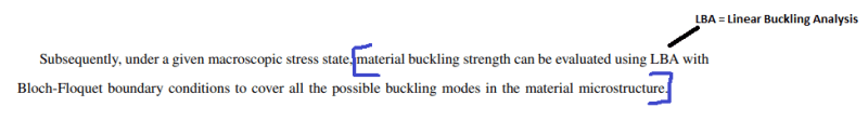

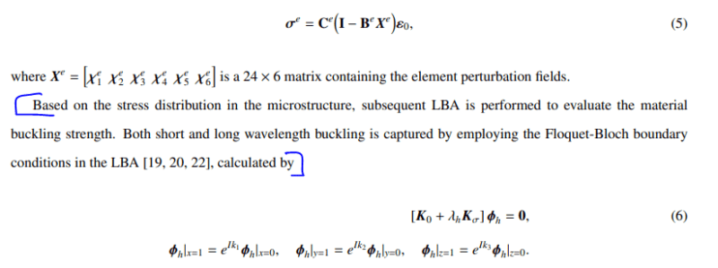

Does anyone understand how Floquet-Bloch boundary conditions work in this context? Seems like Bloch-Floquet boundary conditions can do anything? Would it be possible to explain in layman's terms how it works? I have spent hours trying to read up on it but still cant figure it out.
Going back through some (elastic) wave propagation texts of mine, this appears to be a necessary boundary condition when using the wave types necessary in periodic structures (i.e. structures composed of repetitive similar units) or composite type structures.
Of course, the boundary conditions are critical in any wave propagation study.....but unless you are doing some unusual nondestructive testing for your field (your discipline is marked as "Civil/Environmental").....I'm not sure how much use it is.
Then again, for all I know, this boundary condition could be used in some spectral FEA software (somewhere) for other applications.

It goes into Floquet-Bloch boundary conditions. (And in fairly understandable terms.)
One thing about elastic wave propagation analysis (using spectral FEA software; and to put this as close to "layman's terms" as possible): there are all sorts of elements/boundary conditions to get the appropriate response. (I.e. allow certain waves and frequencies to pass.....and in other cases: get rid of them.) The so-called "throw-off" element is another example. It is a element used when modeling a very long structure where the reflection of the elastic waves would not give a significant response. (Ergo you want to "throw-off" (or out) the elastic wave once it reaches a point.....rather than modeling something too big for your purposes.)
