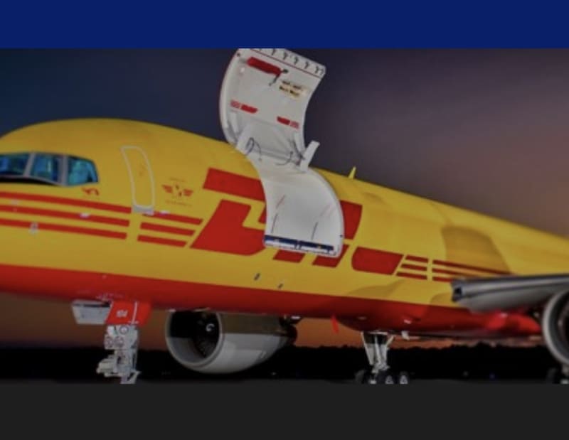

The item you quoted states that the "aircraft sustained substantial damage". Now if this is a photo of the actual aircraft...
...I don't really see any damage. That being said, if the door opened to the extent shown in the above photo while in flight, I'm amazed that it was able to stay aloft at all, let alone land without serious incident.

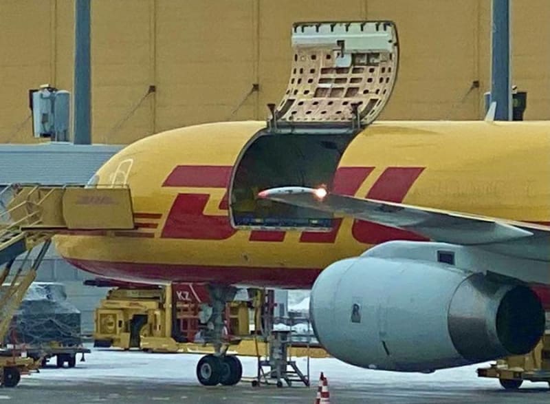

Here's another photo supposedly of the same aircraft:

Can't see any skin wrinkles.

It will have bent the framing although no wrinkles .Luckily no cross wind with that foremast resitting the rudder.

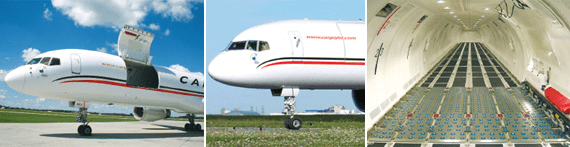

I suspect the "substantial damage" is to the door and related systems (frame, hinges, latches, etc). This photo of another 757 cargo conversion shows normal opening angle. The inner paneling of the door on the damaged aircraft appears to be missing, that might be the debris that was reported to have fallen off.
I thought that as well but the photo from my link looks like this.
Good spot! Though there's still all the missing paneling from the door interior, even if the hinges aren't damaged. It might just be cosmetic, but I'd bet (given the quote about substantial damage) that the hinge/latch system was damaged. Not "debris pulled into an engine" damaged, but still not likely to be flight-worthy without repair.

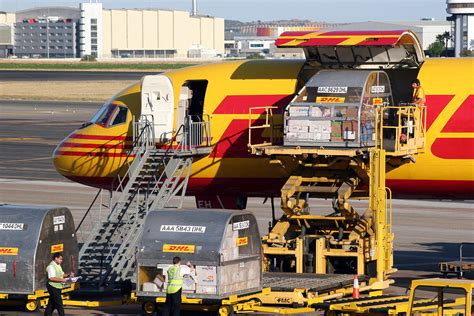

Here's one loading.
That is all the door has to open to load cargo.
I suggest that any opening wider than that represents damage.
OOps.Retraction.
It seems as if some models do have extra high opening cargo doors.
