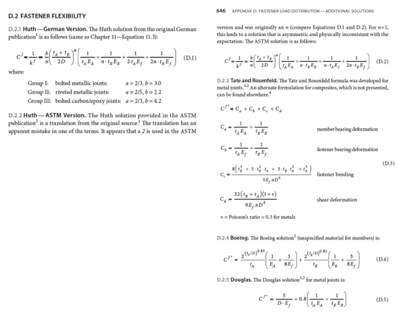

I am not sure what your application is, but this would be a common approach in the aircraft industry (if for some reason a FEM was required):
- Fatigue analysis: Use a liner spring/beam/CBUSH/other element to represent the fastener connection (better not to model the hole but its OK too if you calibrate out the overall stiffness of the connection). Using the fastener loads, perform fatigue analysis outside of the FEM (detail analysis). Sometimes you can use empirical or semi-empirical equations to determine the spring constant for the connection (which is a function of many factors as discussed below).
- Ultimate analysis: Use a nonliner spring/beam/other element to represent the fastener connection (better not to model the hole but its OK too if you calibrate out the overall stiffness of the connection). The nonlinear load-deflection curve must be developed via test based on a representative connection. Alternatively, if you know the connection is bearing critical, you might be able to come up with a reasonable load-deflection based on the assumption that there is a relatively large amount of deformation once the yield bearing stress has occurred. You might also be able to use a linear analysis if a conservative result is acceptable (depends on some factors).
The challenge with using a FEM as you suggest is that you are attempting to create the actual nonlinear load-deflection curve from the FEM, based on the actual physics of the problem. I am not sure you realize how challenging that is. The deformation is a function of at least the following: member bearing, fastener bearing, fastener bending, fastener shear, fastener rotation (tipping), installation factors such as clamping force, fastener fit, fastener type. So unless your FEM can capture those factors (and the nonlinearities associated with them), its not going to be realistic. If you consider something like the plasticity associated with bearing deformation, that alone will be a challenge to represent via FEM. That is why we rely on test data to determine the spring constant for joint connections (and then sometimes create equations to represent that based on specific inputs of the joint). In fact, a bearing allowable (yield and ultimate) are almost "properties" in themselves and would be quite difficult to reproduce with a FEM and the actual material properties.
For the linear solution at least, this figure will give you some idea of what I mean about the factors that affect the joint stiffness/flexibility (from Practical Analysis of Aircraft Composites)

Well, for the linear range, there are semi-empirical solutions for the effective "fastener flexibility" (the compliance of the joint connection), which are based off of test. Assuming the connection is bearing critical and large deformation is expected, you could develop an approximate nonlinear load-deflection curve based on the bearing yield stress and bearing ult stress. If the joint is shear critical, you won't have as much nonlinearity and a linear solution may be representative of the actual response.
We have to break the problem into two conditions though. For a fatigue analysis (loads relatively small compared to the ultimate load capability), there may be local yielding, but the fastener loads are still such that that a linear analysis is acceptable. We commonly use semi-empirical fastener flexibility solutions for that scenario. For an ultimate analysis, there can be a significant amount of deformation which allows for a redistribution of the loads on the fasteners (which you may or may not want to take advantage of).
With respect to the ultimate load condition, there may or may not be a significant amount of deformation. This will depend on the failure mode (shear critical vs bearing critical...or possibly a bolt bending failure). To actually replicate a bearing failure (and associated large deformation from bearing failure), would be a challenge. First, you should recognize that compression allowables are not designed for something like a "bulk compression" so you may not have anything to even input to the FEM with standard allowables. This is why the the stated compression allowable can be much different than a bearing allowable even though a bearing stress is basically a compression stress (how do you propose the simulate that via FEA?). If there is significant fastener bending at ultimate, you might need a 3D FEA to truly simulate that effect. I am not aware that there is a FEM analysis that can generate the actual nonlinear load-deflection of the connection using basic material properties (even if it is a 3D, contact, material nonlinear model). I am not even aware of a FEM that can generate a joint allowable (or even a bearing allowable) from basic materials properties (tension, compression, shear allowables). Give it a shot..try to predict a bearing load capability from FEA via the compression allowable.
In the end, if you want something accurate, you will have to rely on test data for the joint connection. This may come from an equation (such as the ones posted above), but that would be backed by test data. If you are aware of a FEM (even the best 3D one with all the bells and whistles) that can accurately predict the load-deflection response of a general joint connection (and the associated joint allowable), please let me know. You can probably do it for some failure/deformation modes, but I am not sure it can be done for a general connection.

Perhaps this may help? Your first start with determining the load-deflection curve (linear or nonlinear) of the individual connection. This could from a semi-empirical equation or directly form test data. You then use the FEA to represent the actual structure (may have many fasteners), where a spring/beam/CBUSH (your choice) element represents each individual connection. I think that may be what you are doing, but I want to be clear.
Regarding the size of the fasteners w.r.t. the plate, have a look at this recent thread. If you don't have a connection interface (represented by the fastener flexibility), you won't be able to get the correct loads on the fasteners. I think you are also doing that, but it is a good example why it is still important to represent the connection properly, regardless of the size of your plate/fastener.
Thanks for clarifying about what you were doing with regard to how you use the fastener loads and that makes sense. I don't think we are too far off, I just wanted to clarify some things in general (since FEA of bolted joints can mean various things).
Also, just as an extra note, the linear slope of the load-deflection curve is a function of various parameters (member thickness, fastener to member eleastic modulus ratio, diameter, etc.), but the nonlinear portion of the load-deflection curve is a function of the failure mode. For example, if the joint is shear critical (fastener fails in shear), there won't be much elongation before fracture (its not very nonlinear at all) as opposed to being bearing critical (which has a relatively large amount of elongation before fracture). In other words, you can't always expect fastener load redistribution and a nonlinear analysis would not change the result (though it is often good practice to design a joint to be bearing critical to allow for load redistribution).

The load-deflection curve is just another way to determine the "connection stiffness" or "fastener flexibility". Its nothing more than F=kx.
The reason I chose to say load-deflection is that it implies consideration for the nonlinear range (since load and deflection are the direct outputs from test data). And when you do a nonlinear analysis for fasteners, you may be provided the load-deflection curve and then create the appropriate FEA input from that (you may have to break it down in a set of piecewise linear stiffnesses). In engineering slang, I am used to "fastener flexibility" as implying just the linear slope (a single value). Note that even the term "fastener flexibility", which is commonly used, is slang since we actually mean the flexibility of the connection (which is a function of factors beyond just the fastener).
Here is a basic overview. There are some details I left out, but this is the basic concept.
1. Start with testing a single joint connection (a single fastener and its plate members). It could be singe shear, double shear, etc. Apply a load to the plate and recover the total deflection. Next, we subtract the deflection associated with the plate members (where the plate stiffness is AE/L). What remains is the load-deflection curve of the joint connection (which accounts for various factors such as fastener shear deformation, fastener bending deformation, member bearing deformation, etc.). As stated above, we would not try to determine this load-deflection curve from a FEM because it not be an engineering solution (the FEM would be quite complex).
2. From the load-deflection curve, we can determine the linear “fastener flexibility” or “connection stiffness”, which is just the slope of the curve in the linear range. If we have enough data from a variety of joints, we can create a semi-empirical equation. From the end-user perspective, this may amount to a ready-to-go equation for the linear range or we may just go back to the load-deflection (if it exists) if we want to perform a nonlinear analysis.
3. Model the connection in the FEM with a spring, beam, CBUSH, or other element where you can simulate the stiffness response from item 2 (and effectively item 1). It doesn’t matter how you get there, as long as in the end you can reproduce the basic load-deflection response of the connection. For example, if you use a beam element, you would have to “back out” what the A, E, L properties would be to achieve the desired result. A spring or CBUSH is more direct.
3b. I don’t want to get too carried away with this, but some recommend you calibrate the solution. For example, if you place a spring element directly to a quad mesh, the point load at the interface will cause the shells to locally deform. This is a function of the mesh density. One way to address this is to create a representative connection and calibrate the inputs to achieve F=kx of the connection. In other words, you would want to get back to the response from item 1. You can model the hole if you wish, but ultimately, you want to get back to the response from item 1 since that is the basis for everything. In my experience, I haven’t fastener flexibility to be such a sensitive parameter that it normally requires this calibration, but it is something to consider.
4. Linear Solution. If you are performing a fatigue analysis, a linear analysis is sufficient. This is because the loads are such that significant deformation at the connection will not occur and therefore there will not be redistribution among the fasteners. If the connection is shear critical (shear failure of the fastener), there will not be significant deformation at the connection so there is no need to run a nonlinear analysis. Now let’s assume there is a significant nonlinear behavior of the joint connection. If you can demonstrate the connection is acceptable with a conservative linear solution (because some fastener loads are predicted to be higher than if redistribution was allowed), then you may not need to run a nonlinear solution. Just to be clear, at this point, the FEM represents a more generic joint (with multiple fasteners) and not just an isolated fastener connection.
5. Nonlinear Solution. In the event that the load-deflection curve of the connection has a significant nonlinear portion (due to either being bearing critical or bolt bending critical or other), you can perform a nonlinear solution (if this is actually required – See Item 4). Again, the inputs to your FEM connection element just needs to represent the response from item 1. It doesn’t matter how you get there. The advantage of this solution is that you can account for fastener load redistribution (if it exists). The disadvantage is that you need more inputs to define the load-deflection response and have to run a nonlinear solution.
6. Post processing. After you recover the fastener loads, you check them against various failure modes (shear fastener failure, bearing failure, etc.) or directly if you have the joint allowable.
