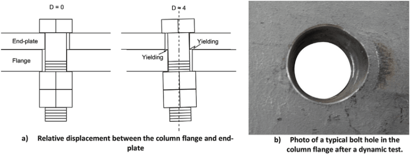

I take issue with this assumption. In tension we normally have significant preload on the bolt the bolts behave extremely stiffly through most of their strength range. A 1/2" plate is not particular stiff in an end plate type connection.
With bolts in shear we again have the bolts bearing on the holes. Here the flexibility comes from rotation of hole slop AND also localised point yield of the bolt hole in contact with the significantly harder bolt.
So in both cases flexibility of the joint is as much if not more so from the mild steel items.

Yeah so like a shear/fin plate. The flexibility is from the bolt hole and also hole deformation.
In fact some advice warns against using 'thick' fin plates because they deform less and thus the connection will behave less like a pinned connection.

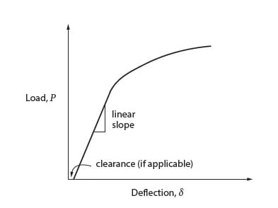

No, that is not what I am saying. I think I confused you, so I will try to keep it simple. Simply input the load-deflection of the connection to the FEA (whether it is linear or nonlinear, depending on your goals)...that is all. The load-deflection curve may look something like the following figure (we might omit the clearance part or adjust for it). It doesn't matter how you get there (F=kx), as long as you can reproduce the load-deflection curve via the FEA. For example, if you just want to run a linear model, then input the linear slope (k in F=kx). This could be done with a spring, beam, or CBUSH element and the connection stiffness could be determined via an equation (original basis is from test data). This is the most common way to model joints in practice.
from "Practical Analysis of Aircraft Composites"

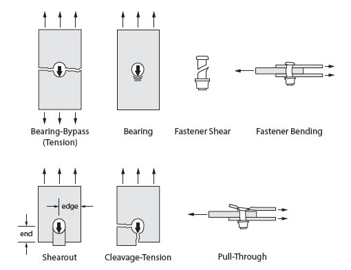

The linear region (linear stiffness) will *not* be a function of the failure mode. However, the nonlinear response will be a function of the failure mode. If the joint is bearing critical, there will be more elongation than if the critical mode is a fastener shear failure. For example, human909 showed a picture of what appears to be bearing elongation, which is part of the nonlinear region. Either way, you need to know what the load-deflection curve is for the individual connection, and input that to the FEM, if you want to run a nonlinear analysis.
from "Practical Analysis of Aircraft Composites". Note this figure is for general composites and the bearing-bypass mode does not exist for metals (w.r.t. ult failure).
