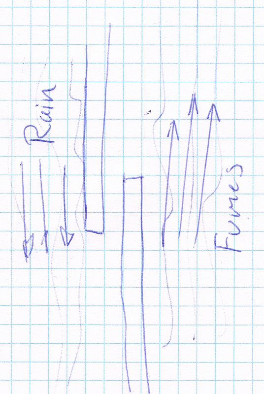

The chimney will discharge the fumes produced by a backup heating system and will only be used less then 500 hours per year. The Chimney has to be 7 meters to have an high enough dilution factor. The chimney has te retract to about 2,5 meters to be out of sight when the backup system is not active.
Our "client" said we didn't have to take economics into account and agreed with our plan. It is more of a school project than a real internship.
The upper segment will have a bigger diameter, so that fumes will not leak between the gaps of the segment (because the fumes rise) and rainwater wil not leak between the segment(because they drop down). Also there will be an chimneyhood installed on the top.
