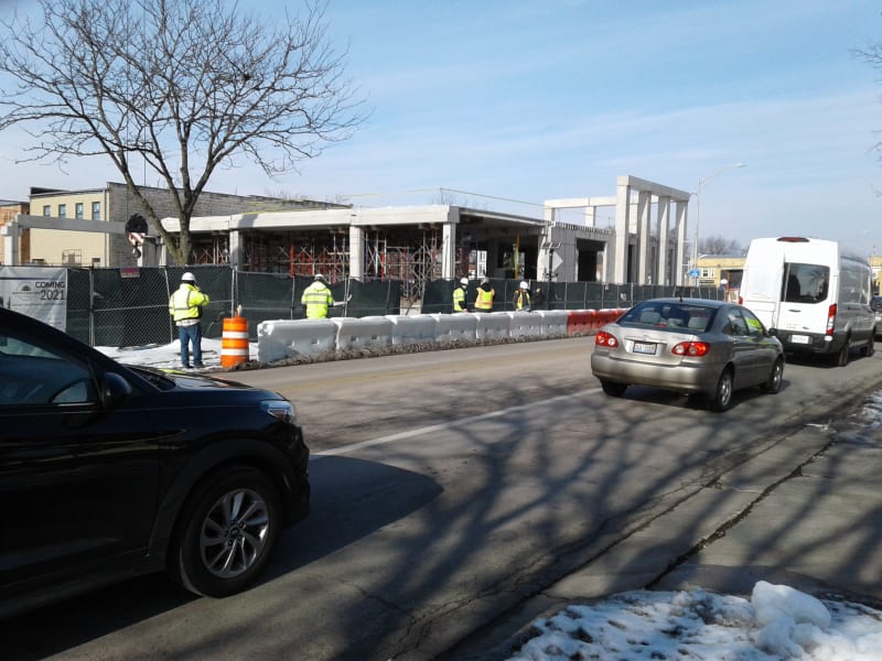

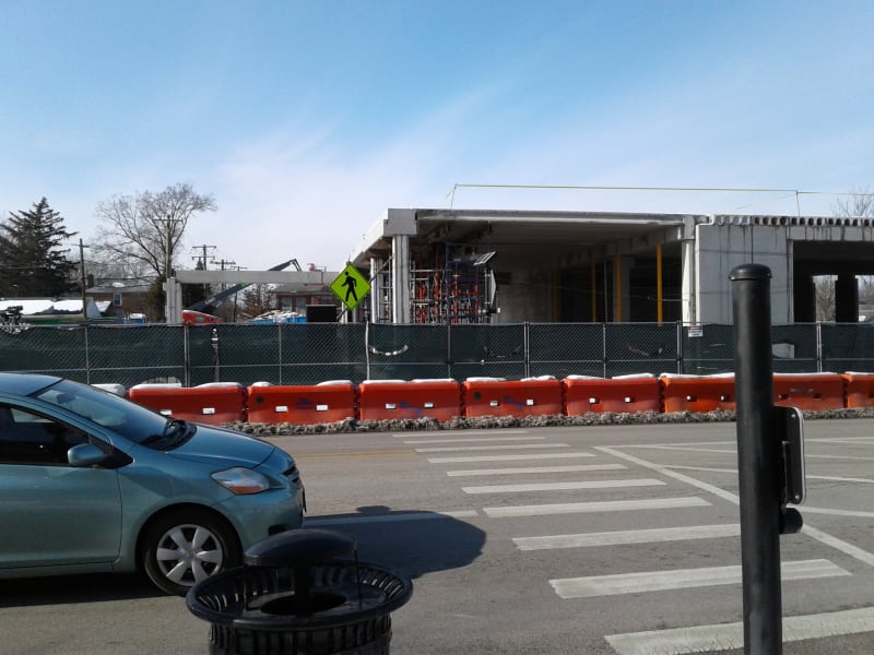

Two people were critically injured in a partial building collapse of a building under construction in suburban Chicago Illinois on Monday afternoon, December 28, 2020, Westmont village officials said. A spokesperson for the village said around 12:30 p.m. there was a partial collapse at a new multi-use condominium building under construction at the intersection of Cass Avenue and Quincy Street.
Quincy Station
Link

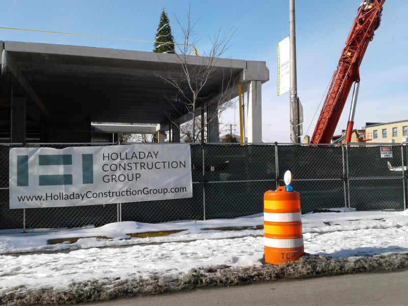

Speculation at the moment, but precast structures like this often have stability issues before everything is tied together. Or, as there are some pictures of cranes which seem a bit askew, it could have been a lifting failure?
It looks perhaps like at least one of the 'cranes' may have slipped or sunk into something. It seem to be sitting pretty low on the job site. Could there have been a foundation or retaining wall collapse resulting in some earth moving under the equipment?

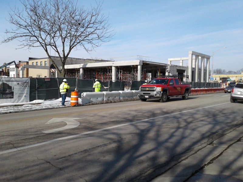

OSHA inspectors were on the site today with a drone. Both ends of the structure are now propped up with temporary supports. The question is whether the structure will have to be taken apart and re-erected.

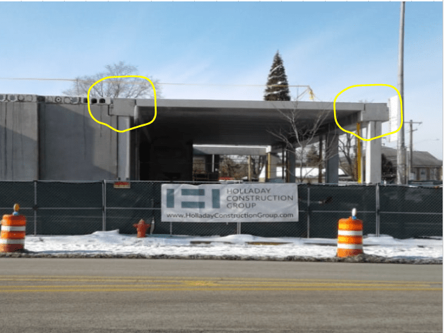

Those precast beams seem have rotated.
the outer one being a spandrel and the inner one seems to have the floor spanning on one side only... with the plank on the LHS spanning the other direction.
And that looks like a might split at the top of that one column.
Damn precast. Again.
Precast is great in concept, at least.
The robustness of the connections is what gives me the most heartburn.
My strong hunch is that partial collapses during construction occur with precast structures (like the one in this post) far more than cast-in-place concrete or structural steel erection.
Can't prove it, that's just my sparse data set in the framework of my biases.

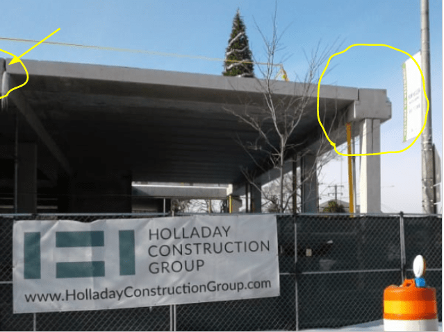

any suggestions why the column would be split? I cannot think of any, not with the large wide precast beam over.
Honestly no I don't have any idea why the column would split like that. Normally I would say a split like that in a concrete member would be due to localized rebar corrosion causing expansion and tension splitting. But a barely loaded, brand new column, doesn't strike me as a candidate for either corrosion or overloading.
Maybe torsion from the beam cause a pry-out type failure of whatever dowel type fastener they had into the top of the column? That's my best guess. You'd think there'd be enough ties near the top of the column to prevent that however.
Don't feel bad... I couldn't think of a good reason, either...
My guess is that on the left side in the yellow circle, water has been accumulated between the elements and then frozen and expanded so that the roof beam has been pushed to the right.
Maybe that is what has made the crack on the right pillar or the pillar has not been completely dry inside, due to the water inside the pillar, the water has frozen and expanded until it cracked.

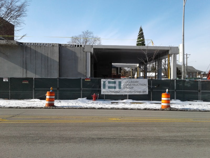

I don’t think that’s a crack. There are drip stains from water or something all over the structure.
Good catch, you may be right that it's picking up something from the bearing pads and staining the surface.

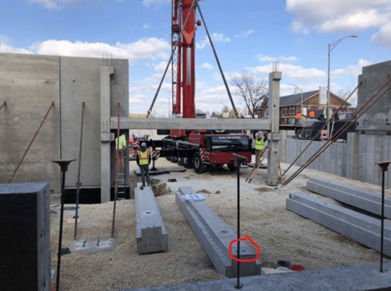

Also, in looking at some of these pictures, there appears to be a significant lack of erection bracing in place. Hollow-core diaphragms rely on the grout and all the tie-bars being in place. So even if they started erecting next to the shear walls, there's nothing bracing any of the columns away from the shear walls until the grouting is complete and cured.
bones... that explains the 'crack' I couldn't think of a reason for... thanks

I thought it was a crack at first too. Perhaps it was grout dripping down? Looks like they utilized grout sleeves:
