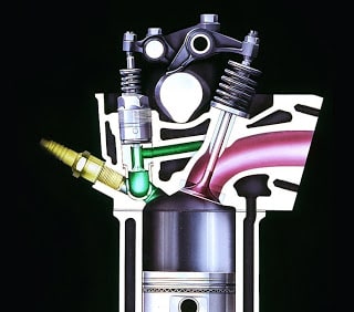

Interesting adoption of F1 tech to high performance street bikes. I can see some real benefits to that rotating shaft between the pre-chamber and the combustion chamber but also some potential problems with carbon build up, oil seal leakage, etc.
Carbon buildup was never a big problem for pre-chamber diesel engines though gas seems to leave some harder deposits due to alkanes?
No oil seals necessary. This is all driven within the engine. A small amount of lube bypassing is no big deal, better than lube lost through valve guides as this one has a chance to burn.
Exhaust blowby into the crankcase will be managed by the PCV system the same as blow-by through valve guides.
Sealing will most certainly be necessary. They have a rotating shaft the length of the engine passing between all four cylinders and into the crank space where the drive mechanism is. There has to be sealing between adjacent cylinders to avoid combustion pressure leaking between cylinders. And that shaft is going to have to be made of something special to withstand the operating conditions.
The F1 version (that we the public know of) uses a fixed prechamber but no direct fuel injection into it, it's completely passive (rules prohibit more than one injector per cylinder). There's another version (not for F1) that uses a direct injector and an external injector with a fixed prechamber. But it wasn't developed by Honda, so I suppose someone wants to bypass patent royalties ...
A little bit of exhaust communication between cylinders shouldn't cause much trouble. Simple labyrinth seals should be sufficient here.
At combustion pressure? That would act like a blown head gasket between cylinders.
I suppose if the space for the shaft is a single diameter the whole length, and arranged for a tight clearance fit the whole length, the leakage path would be the clearance between the two and the cylinder bore spacing less the prechamber diameter, adding to the resistance to flow. I just don't see this happening relative to the Mahle setup that has no extra moving parts.
