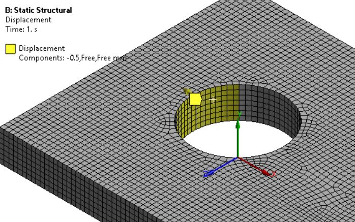

Hi all,
I understand we don't take stress at the boundary condition especially SPC.
What if I apply displacement across an area, is the stress at this area valid for assessment? Thanks!
Hi SWComposites, I uploaded the picture... I wondering if I could just directly take the stress of the area with applied displacement or I have to model another part with contact element to the bolt hole...
how real is this enforced displacement ? if it is a step function then not very real so I'd average.

Basically, the area will be pushed to a required distance ... and we would like to see if this area will be damaged... some directly pick the stress at this area... I am thinking to model another part with contact element in between then assess the stress there...
ok, but is the representation of how this displacement is applied to the part realistic ? like a contact, or a sine distribution. Your sketch looks like a 120deg sector has this displacement applied, so the elements at the boundary are going to be very confused.

Predicting “damage” for bearing load is a VERY complicated, difficult problem.

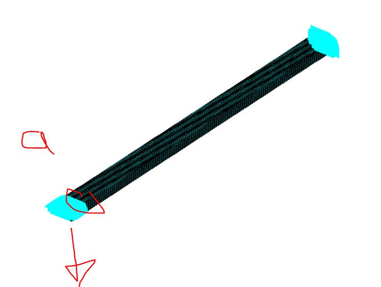

I am uploading another picture which is more relevant to my problem.
Let's say there is a beam and I press the end up to 0.5cm and if I want to assess if the area where I press it would result in any risk of failure, can I check the stress directly within that region?

I understand that we do not take the stress at boundary condition but not sure about this
IMO, no.
FEA gives us a view into a much deeper world. In hand calcs no one asks "what is the stress 1mm away from the point load ?" 'cause everyone knows a point load is artificial.
You've applied an enforced displacement to a cantilever. Hopefully you applied the displacement to a single node (or a very small group of nodes) and not to the blue "blob" at the end of the cantilever. Displacing the entire blue area says within the blue nothing much is happening (it's all displacing the same) and at the boundary merry "hell" is happening, as one atom of Al looks at it's pal microns away and sees this instantaneous (in terms of length along the beam) displacement. I'd do a hand calc at the boundary of your enforced displacement ... shear on the cross-section. If you want to kill it with analysis, then maybe a shear lag calc from the load point.

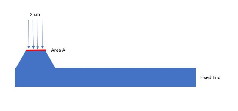

Actually, it is a snap fit design...there was damage at the point of applied displacement...
Someone from my group taking the high stress at the area where enforced displacement is applied to judge the reason of damage...but I do not feel comfortable to take the stress at where the displacement applied to... Another reason given is it is conservative but... I am still not fine with it...
Note: P is where the displacement applied...

so something is riding up the ramp, pushing the latch down, until "snap", the thing travels past the end of the ramp. If you're seeing damage, this is something I'd look into ... the impact load of the "snap".

That snap fit part will fail at the base of the tang, not at the location where load P is applied. So no need to consider any stresses at the location of load P.

agree with SWC, the critical section is most likely the fixed end of the cantilever.
I think I should not say linear model is not conservative but I am skeptical at taking the stress at enforced displacement region (Area A)..
Yes... the failure should be at the root but there was some damage at the Area A...the team interpret the high stress at Area A resulted the damage ... but I think the high stress is due to displacement
