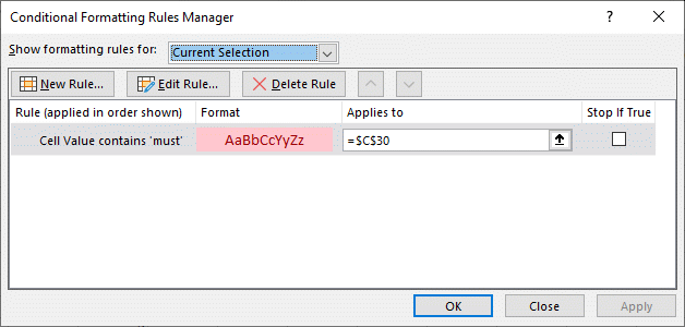

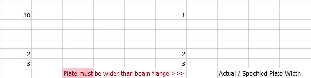

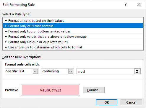

Pretty straightforward with conditional formatting; I chopped out some rows and columns for simplicity

Got it!
Success!
Just gotta know how!
Thank you all!

I almost always use
Use a formula to determine which cell to format
in my CR Rule Type.
In this case the formula I'd use is
[tt]
=AND(F35<F24,F34<F24)
[/tt]
...so when that expression is TRUE, the CF is applied. These are the values that the IF is using.
But I absolutely hate cell notation! I would be using Named Range names in all my references. Makes understanding what's going on much easier!
PS: something else to consider. What if the boss wants the wording changed to exclude the word "must"? The criteria may be met in cells F34, F35, F24, but the CR criteria is not connected to the main criteria, but some other arbitrary value that has nothing to do with F34, F35 & F24.
