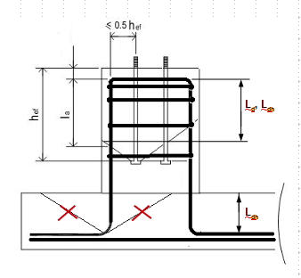

I need to design a reinforcement to resist moment loads from the column on top of a stem wall. There is a lot of information out there on anchoring to pedestals, but not so much when it comes to rectangular footings. Concrete breakout is a controlling factor, so I am adding vertical reinforcement with loops encircling entire width of the wall on top and standard hooks at the bottom. My issue is that bottom footing is not deep enough to resist the breakout either.
What would be an effect of adding longitudinal reinforcement to the stem wall, may be make a section of it into a beam? Would it help to distribute the load from the anchors over a longer footing area, so steel which is farther away than 1/2Hef from the anchors would also contribute?

1) I feel that your logic is sound with that and that it could be made to work with the right attention to detail. Even without the beam detailing, it's pretty common to assume a 1:1 load spread from your base plate down to the footing for bending.
2) It's strictly more correct to turn your dowel hooks the other way but, for the proportions that you're showing, I doubt it would make a difference and your arrangement is more constructible.
For me this would be a little too exotic relative to simpler solutions but it's doable. You're basically turning the joint into a reinforced beam/column joint rather than breakout style anchorage. You'd need a pretty good footing depth to make the detailing workable.
I think your sketch shows the cross section of the stem wall. If I am not mistaken, You need to consider the available/effective concrete area bounded in both direction. The example below uses hef = 10". Didn't ACI address this situation? Link

They did, and I did account for the effective area on all sides. And without reinforcement, φNcbg is roughly 50% of the required capacity

It is not to scale. Stem wall is 14" thick and footer is 12". I might be able to upgrade it to 14", but that is all. It is going right next to the existing structure and digging a deeper footing would undercut foundation
The wall is 20ft long (10ft on each side of the column), so if we could only distribute that moment over a 20ft... Doubt it can be designed rigid enough

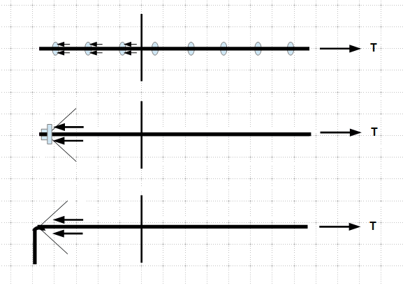

When you design spread footing, is there any suggestion to check the breakout from base pad? I couldn't recall any, but the requirement on development length. Same logic here. Similar concept as develop the rebars of concrete walls in a T joint. Sketch be low is to make sure we are on the same topic - develop rebars in tension. Note the different breakout mechanisms of rebar and headed stud/bend smooth dowel in concrete.
Agreed r13. That is what was behind my question above. Wasn't sure why we were talking breakout with rebar development (two different animals).

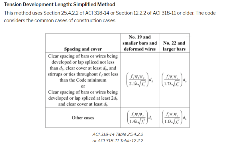

1) Failure mechanism of reinforced concrete and round smooth stud/dowel in tension. 2) ACI do address influence of rebar spacing and clear cover in development length calculation.
ACI table 25.4.2.2 is for straight bars, not hooks. I believe spacing, clear cover and confinement addressed in 25.24.2.3 are more about getting enough concrete to encase the bar on all sides and address 1st failure mechanism illustrated by R13 above.

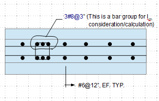

Bar group ≠ bundle bars. The minimum base slab thickness is governed by the longer lDH calculated for the #8 (in bar group), and the #6 (individual). Hope this ends the discussion.
