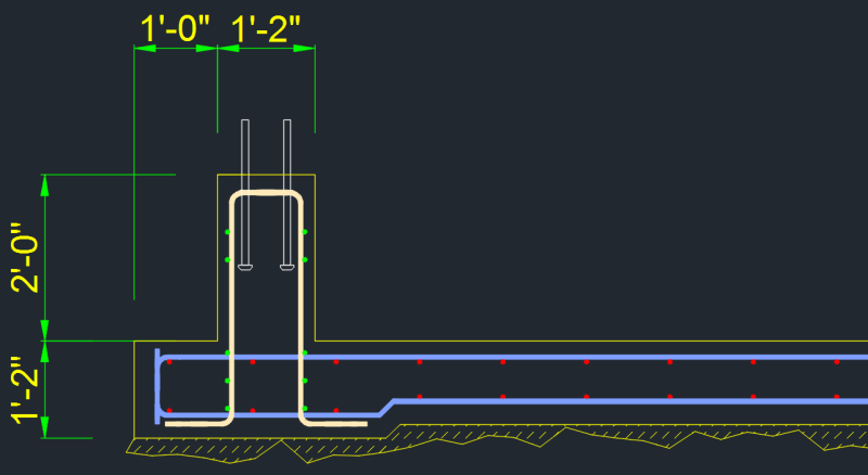

Anchor reinforcement for a stem wall 1
RabitPete
Nov 24, 2020
109
I need to design a reinforcement to resist moment loads from the column on top of a stem wall. There is a lot of information out there on anchoring to pedestals, but not so much when it comes to rectangular footings. Concrete breakout is a controlling factor, so I am adding vertical reinforcement with loops encircling entire width of the wall on top and standard hooks at the bottom. My issue is that bottom footing is not deep enough to resist the breakout either.
What would be an effect of adding longitudinal reinforcement to the stem wall, may be make a section of it into a beam? Would it help to distribute the load from the anchors over a longer footing area, so steel which is farther away than 1/2Hef from the anchors would also contribute?

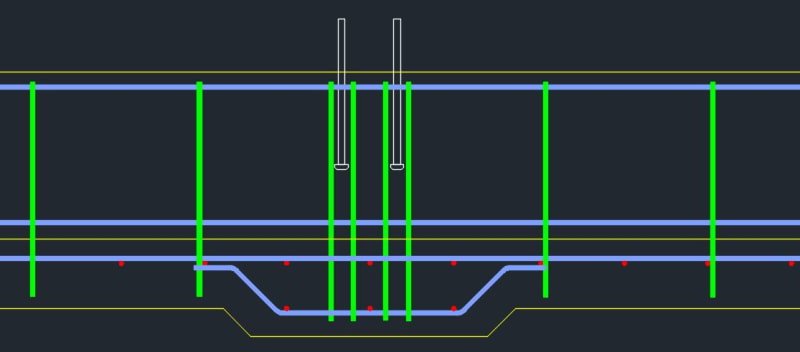

You're only doing this at a local area so maybe just go with the Cadillac and be done with it. Potential detailing problems with yours:
1) Hooks facing the wrong way.
2) Unrestrained tension kinks in your footing bottom bars.
For less critical applications, one can certainly back away from my detail towards yours. That's a matter of judgment though: yours.
Yeah, I did not like the offset bend in the bottom bar either, smelled like trouble. Actually it is not just one localized area, there are 12 of those along the wall, and then there is also a corner. I only showed 1 middle column. I like the idea of U shaped reinforcement to make the hooks face inwards without having separate bars all next to each other.

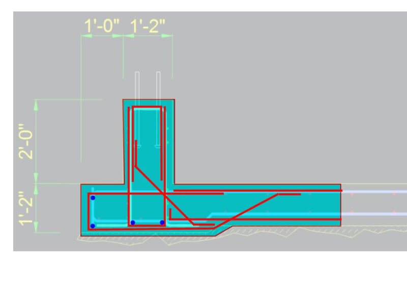

Another option might be to extend a thickened 14" section all the way to the right. I have to do some math, but with 14" thickness and 2 layers, it might only need to be 36 or even 24" wide, the idea is to get it long and wide enough to keep soil bearing pressures under control. I have not even accounted for the rest of the slab which will surely share some of that load too.
Here is what I meant, may be make a 3ft wide x 14" deep grade beam centered under each column to help with distributing moment over a larger area of the slab? 2 U-shaped ties on each side of each anchor (as per KootK details), standard L hooks 12/24"OC along the remaining section of a stem wall. Something about that rebar piercing the grade beam feels neither right no elegant. Every time I think the good solution is here, it seems to be slipping away...
Could someone please explain a little or point to a good source of information on the compression strut-tie system. What shear forces do we need to deal with? Would not I have to add shear reinforcement between compression/tension sides and the same thing in the other direction, so moment in both directions transfers from anchors to the beam?
I am still struggling to come up with a good and simple solution. As the moment can be reversed and also applied in the orthogonal direction, I always end up with some hooks pointing not in the optimal direction.
And as far as U hooks go, should not the U be at least as wide as 2x standard hook lengths for it to be fully developed in tension on both sides?
Sorry, we dropped the ball on this one. If you haven't yet resolved this, report back and we'll try to get it sorted over the next few days. Fundamentally, I feel that your long, thin strip foundation proposal is a little weird and perhaps ill advised. That said, maybe I don't fully understand your intent with that.
This is more of a thin mat foundation, not just a strip under the wall. So the idea was to utilize that entire slab to keep it from overturning or exceeding soil bearing capacity. I posted some of the 3D details in another thread, but cant say I am happy with those. What I have so far is a T-shaped thickened section (14" deep, 36" wide) under each column. I would rather see that moment fully transferred into the stem wall and then distributed over a larger area of the slab, instead of taking it straight down into the slab and relying on a small core.
