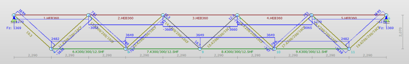

I am still learning about connection design and everything will be checked by a senior constructor but i have some questions regarding eccentricity's.
It is about the following joint:
With the following normal forces:
The diagonal is eccentric towards the upper beam of the truss. This will result in a moment of the horizontal component of the 1700 kN.
So the resulting moment is: 1270*0,18=230kNm
If i test the truss to take this moment like this, (and the UC is ok):
then the moment will be taken by the girder and not the connection?
So like this if i input the forces to FEM software (note that the moment is the opposite direction because this is the internal load of the truss?):
And then i have the same question about the other diagonal thats connected to this joint. Will moment created by the horizontal_load*(height_beam/2) be taken by the upperbeam as an extra moment or will this also go to the connection below? I wil probably move the point up because the plate below is quite stiff in this direction so my feeling is that a bunch of the moment will also add stress to the plate?
And the result of moving the connecting point up means that the moment goes to the connection where i bolt the beam to the plate?
Thanks in advance :)

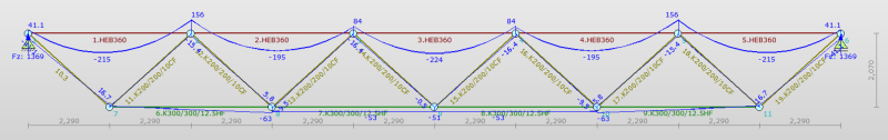

The second picture shows that the truss modelled and analyzed with assumption of simple support and the outcome element forces will be compression for top chord (HEB 360 ) and tension for diagonal element K200/200 ( I assume box 200 mm X 200 mm)..
With the proposed connection detail by OP, the top chord will experience (tension + bending) and diagonal will experience ( compression + bending. )
IMO, the moment connection of a truss from ( top chord + diagonal ) is not acceptable.. The moment connection for truss should be with simple connections with top chord and bottom chord ..
If OP posts the full plan , we may see the other supports and our posts could be more helpful..

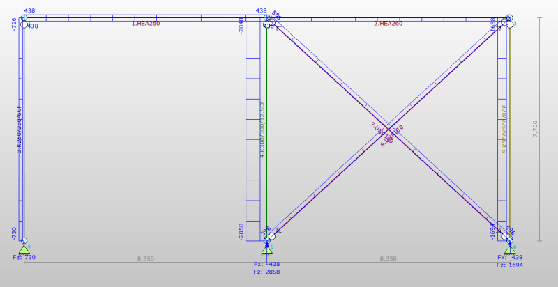

From the figures, I see reactions from 2 trusses and one beam transferring to the colunn through one plate.
The column with beam and wind diagonal. The column in question is the middle one:
Normal forces of the truss:
moments of the truss:

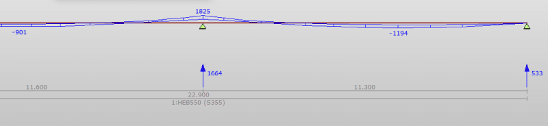

Moment and reaction force of HEB550 (533 kN)

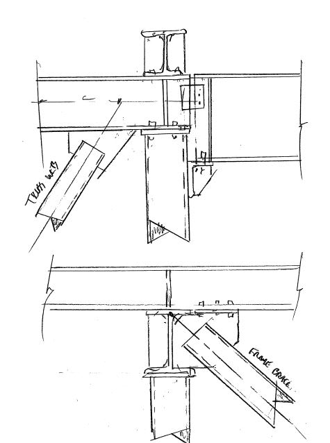

I would tend to gravitate toward this type of connection style first (see attached). If you have any axial load transferring to the deeper beam that opposes the smaller beam, a moment will be created between the workpoints. I'd want to ensure this moment stays within the bounds of the HSS, not a flimsy knife plate slotted into an HSS. I'd analyze this as a simple UFM problem w/ the HSS being the "UFM beam" and the beams as the "UFM columns". The horizontal plates would be designed as end plates.
I didn't draw the braces because I'm in a hurry. Sorry I don't have more time to elaborate, being very busy these, but I hope this helps in some way.

The bracing elements are 2X UNP 160 (and yellow colored at 5th picture yellow colored is that true) ? Are the HEA beams horizontal struts?
If this is true, the work point SHALL be intersection of centerlines of box column+ bracing + and HEA 260 struts...That is, you are expected to extend the column to the top !!
I will suggest you to look to the doc. and develop accordingly..
Thanks for the detailing example! There are no normal forces between the 2 beams. the normal forces of the truss are all internal.
I also looked up UFM. Thats definitly something I have to look at more closely.
But now the diagonal of the truss is hanging freely untill it is bolted to the gusset plate?

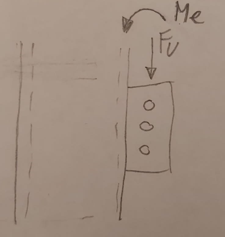

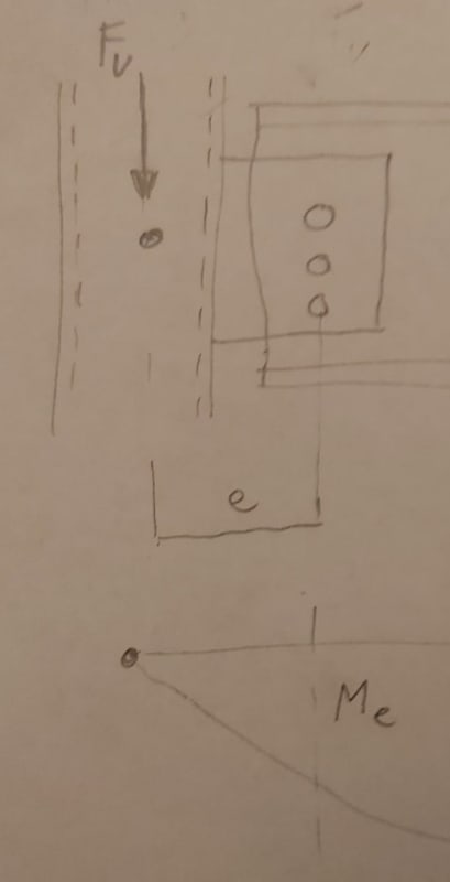

And something that was teached to me is the following but i am not sure if this is true anymore?:
The main wireframe calculation calculated the following, with the added moment graph (example with one beam):

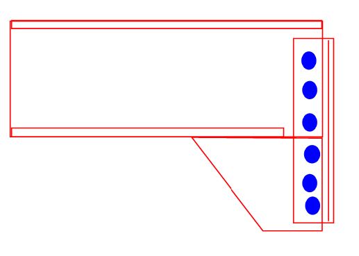

To move the force to the bolts that means i have to introduce an extra moment like this on top of the connection right:
This creates a pretty big moment that cant be taken by the bolts. This was the reason for us to move the connection to the center of the column with the knife plate.
If we dont take this moment into consideration like this that that means the column needs to create the extra moment instead right?

The bracing element is a UNP180 and is indeed the yellow element. And the HEA beams introduce the force to the UNP's. I have moved the centerlines to allign with eachother.
