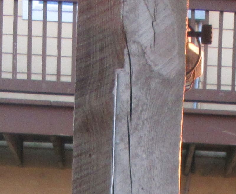

I have about 20 timber piles that all look the same except for 1. These have been in place for several years but most of them have very few splits and of the splits they do have, they are minor in width. 1 pile is noticeable worse than the others.
I was wondering if it is reasonable that excessive wind could make these worse in magnitude if the pile itself was not a very good grade. The splits run on a slight slope and one larger split runs directly to a large through bolt.
Checking and splitting are common. Is it possible that specific one sees more sun, therefore drying, than many of the others?
Is it only on that one side? or are there matching cracks on the other side?
This is a corner column. I did not think to photograph the opposite face. While I am used to splits in larger timbers, the drastic difference in this and the other piles was noticeable.

jayrod12 raises an important point, do those checks go all the way thru the column, as a split or shake or do they only go to the pith of the tree?
Also at the top of the picture it appears that there might be a large knot, approximately the size of the column, with a check in it. That is concerning as knots represent a major change in grain path and a weakness.
Jim
I need to go back and confirm if the splits go through. That is a large knot with a check. I attached a closeup of it. As I said, this column is in much worse condition than any other. I have dealt with large timbers before, but where I live they are only common on the river. That is the only elevated houses we tend to have. I figured eng-tips had some gurus that could steer me in the right direction about assessing why this one was so bad compared to the other 19.

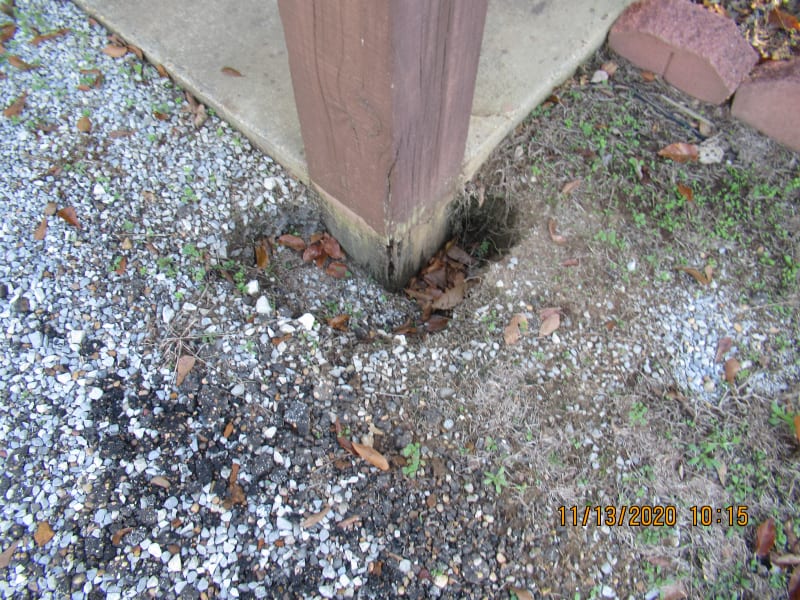

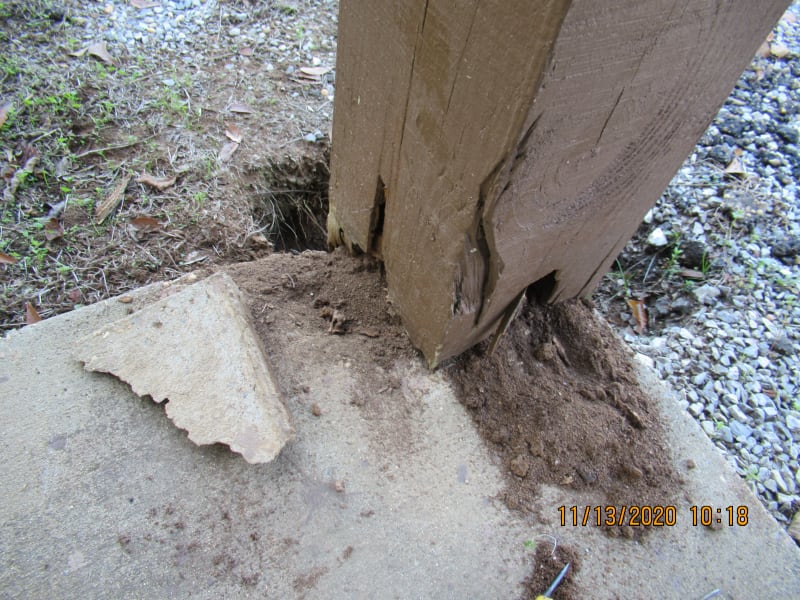

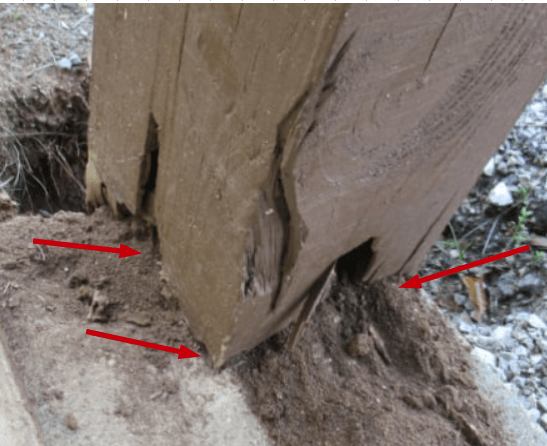

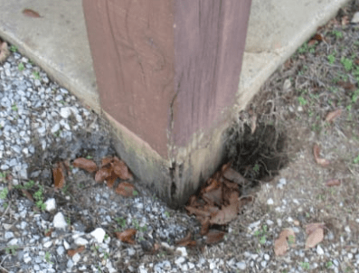

I also attached 2 pictures below of one I looked at Friday. Does anyone have a good method of estimating damage of the portion below the ground? You can dig down a little but then you hit a concrete jacket. I was thumping the bases with a small sledge when this one sounded like I hit a drum. Poked it a little an this stuff fell out. I am assuming this is advanced decay but I guess there is some critter that might be able to do the same damage. No critters fell out of the holes but the debris looks like top-soil. Like the other one, it is a corner column. I think I have learned you better look at corner columns.

It seems concrete pillar below.
The crack doesn't scare me, but that rot does
You do hit concrete a few inches into the ground but I do not know how deep it runs. The Owner said these were driven piles. The exterior face was split but it took very little effort to make those bigger holes in the wood.
That is rotten right at the slab interface. Same as where your fence posts always rot out. Right at the location of constant wetting and drying.
It appears they're relying on cantilever column action in order to work laterally. That poses a bit of an issue for replacement. You may need to look into knee bracing at the top of the new column in order to address the lateral system. I can't imagine they could re-drive a new pile right there.
