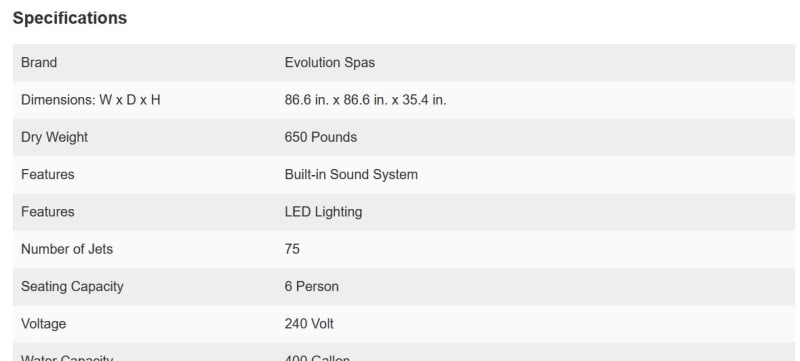

Ok, since I kind of have a hot tub project, too, I'll bite.
86.6 x 86.6 footprint = 52.2 ft2 (rounded down very slightly).
and 650 lbs weight = 12.5 psf.
add 100 psf live load (occupants) = 100 psf (5,200+ pounds, that sounds like a LOT of people, not 6-8, anyway).
and 400 gallons (presuming the occupants don't cause it to overfill, using 62.5 psf for I guess salt water tub?).
400 gallons * 8.34 lbs/gallon - 3,336 lbs. (63.9 psf on the full footprint, which is unrealistic, say 3' height, then 4.2' square, so 187.5 psf, that's 34% of the footprint that seems really unrealistically small, so the load is overestimated).
1" freeboard (for overfilling) - = 86.8 x 86.8 x 1 / (12)3 = 5 psf or so.
Tub - 12.5 psf
Water = between 63.9 psf (full 52 ft2) and 187.5 psf ( on 34% of the footprint) - 0 on the remainder.
occupants = 100 psf.
Range = 112.5+63.9 (unrealistically low) to 187.5 (unrealistically high)
Range = 176.4 psf - 300.0 psf.
So, PhamEng gets the gold star.

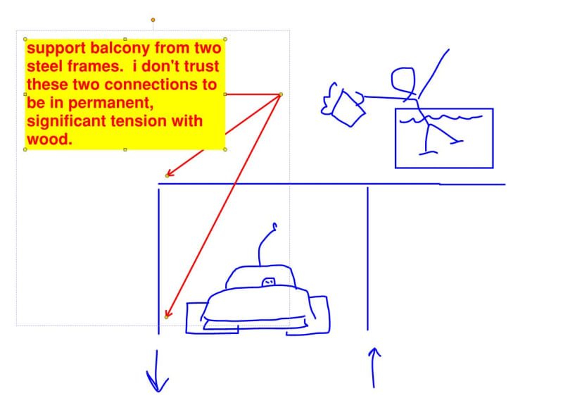

Most want a recessed hot tup when putting on a deck. You simply create a steel frame to support the hot tub and rest of deck is wood. The cost depends on a contractor. When you find a contractor who can put up steel, weld, and frame wood without blinking an eye, keep that contractor. Because it does not have to cost 20K extra to add a few steel beams to support a hot tub. I've even talked with one contractor who blanket prices steel at $1000/LF of steel, lol
