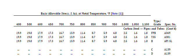

The engineer is stating per ASME B31.3 Table A-1 does not denote an allowablle stress factor for X52 in the table...
The Material is US made DSAW API 5L X52 PSL II 42" std (.375)
We substituted X52 for grade B and he is not allowing it?
He Writes:
HI Fred
I have communicated this information to the PEI at S***l, see his reply below.
Per ASME B31.3, there is no allowable stress value for API 5L X52 at the temperatures of this system. See snip below.
I am seeking a rebutal to have him allow X-52 to be utilized for his application.
As always thanx in advance,
-=Fred=-

As stated by the engineer and shown in the snip you posted, there is no allowable stress value for X52 (at 650°F) in B31.3 Table A-1. However, there is an allowable stress value for API 5L Grade B, which appears to be what they originally specified.
Don't substitute without the engineer's prior approval.

The pipe company should not ignore requirements and/or substitute without documented engineering approval.
Section 323.2.4 gives the designer an option to use listed materials above their listed temperatures, but this requires data "obtained from a sound scientific program".
However, per Table A-1, note 55 is applicable to X52:
Note 55 states:
As a designer, even if I had sound scientific high temperature test data, I would not want to approve a material for high temperature service when B31.3 explicitly warns that this material is not intended for high temperature service and when other suitable material is a reasonable option.

API 5L X52, or any other material, is NOT TO BE USED at temperatures where allowable stress values do not appear. API 5L Grade B is also not allowed to bu used at those temperatures as well.
API 5L max Temp is 400
Reality used to affect the way we thought. Now we somehow believe that what we think affects reality.
7.0 - You're not in this instance correct, i.e. "Grade B is also not allowed to be used at those temperatures as well.
API 5L max Temp is 400"
API 5L Grade B does have a stress value at 650F in table A-1.
All the API 5L X-- grades finish at 400F, but Grade B doesn't.
I am simply amazed that the purchaser ( the mysterious pipe company) did not specify the grade of material they wanted.
You're going to have to trust me that the API 5L listed on the RHS is on the LHS 5L Grade B
Now why anyone wants to Use API 5L in this instance is a bit of a mystery when better steel grades are available or equal e.g. A106 grade B
Correct ASTM A106 B is preferred over API 5L
API 5L plainly states it is for pipe to be used in conveyance of oil, gas and water, however that is never done at 400+, Mismatched material.
