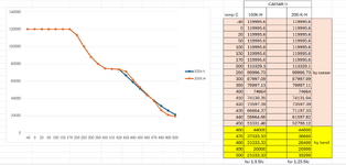

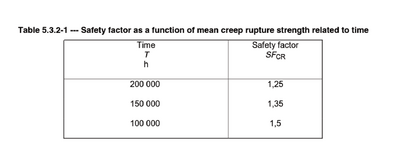

Yesterday at 11:37 AM #1 R rafaresma Mechanical Joined Mar 3, 2025 Messages 2 Hi friends, Why does the allowable stress for material 1.0345 in the Caesar II program appear to be greater at 200,000 hours of operation than at 100,000 hours of operation?
Yesterday at 6:34 PM #2 Doug Hunter Automotive Joined Jul 24, 2023 Messages 163 Location US What is the source of your values? What is happening the the test samples for 100,000 and 200,000 hours? Upvote 0 Downvote
