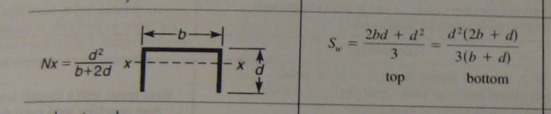

Hello!
P1 and P2 have exactly the same conditions except top, bottom horizontal welding.
I thought P2 could support greater vertical load.
But...
Which one do you think can support greater load? Why?
Thanks!

To specifically address your question on capacity though:
If the welds are all the same effective throat and you ignore any bearing compression development with the embedded plate.
The two configurations have equal capacity using an elastic analysis because the elastic section modulus Sx is unchanged.

RE: Welding Capacity Calculation
Azcats:
The only difference will be which is Sw,top or bottom with the same applied moment = P*e, consistent effective weld throat, and no compression development with the embed.
for Bending stress:
In the P2 orientation the max unit stress on the weld will be a compressive stress at the bottom of the vertical weld lines, P*e/Sw,bottom
In the P1 orientation the max unit stress on the weld will be a tensile stress on the top of the vertical weld lines, P*e/Sw,top
However with the flipped orientation Sw,bottom for P2 is = Sw,top for P1, so the magnitude of the stresses will be equal
For Vertical Shear Stress:
In all cases the contribution to the unit stress from P is just P/A,weld, where A,weld is assumed to equal to total length of weld.
With the magnitude of the weld unit stress being √ σ,shear^2 + σ,bending^2 , resulting in equal design unit stresses for either orientation.

My mistake - I understand what you're saying now. My head was only looking at tensile stresses...
The fact is Ix is identical for both cases. Upon finding neutral axis, ATOP = ABOT, then for same bending on the cross section T ≡ C, and lever arm distance remains the same, so the capacity.

I agree with you... P2 can support greater vertical load. If we consider shear , both alternatives have exactly the same shear capacity. However for bending, P1 upper sections of vertical weldments will experience more tension stress and will start yielding before P2 case. This is due to bearing compression development with the embedded plate which the NA will be lower than P2 case.

Numerical example. Note the small discrepancy in tension and compression forces is due to roundoff.
r13, your calculation assumes the face of the angle against the embedded plate is extremely rigid compared to the embedded plate and you're neglecting any bearing pressure between the angle and the embedded plate.
For P1, the horizontal weld does nothing if the angle is placed firmly against the embedded plate - in this case there is direct bearing between angle and plate. If there is a gap then the weld must transmit the compressive forces, but it is more likely that the angle would be placed tight against the embedded plate.
For P2, I don't think the horizontal weld is fully effective until the vertical welds start to fail. Think about how the angle has to deform to deliver load to the horizontal weld...you would develop separation between the angle and embedded plate, which can't happen because of the vertical weld.
For both cases the horizontal weld is mostly for show. I consider both details to be equal. P2 would be better if you could flip the angle and put the vertical leg down and keep the weld on top.

R13, analyzing stresses in a weld group as equivalent couple forces is not a correct approach. In an extreme case, this method could overlook a peak stress at the tension toe of a fillet weld resulting in progressive/"unzipping" failure.
While we all appreciate your enthusiasm and contributions to this forum, you do tend to post incorrect or misleading statements with alarming frequency.

The calculation was to clear up my comment made before - strength-wise, the two cases are identical.
I don't quite understand your bringing "bearing" into traditional weld design calculation. Question for you, don't you count the horizontal weld for shear, though it's not needed for compression?

I agree P2 with the angle flipped (or stiffened) is the highest capacity configuration.
I think that even as shown, the P2 horizontal leg will contribute slightly to the weld group capacity because of some weld ductility at the top corners. But depending on the proportions, I would be unlikely to rely on it fully or even partially due to the concerns CANPRO raised.

r13, draw a free body diagram of the angle - there are contact forces (bearing) between the angle and the embedded plate that most definitely effect the weld demand.
I would count the horizontal weld for direct shear resistance, but in comparing the two details this contribution is identical.

You think so Celt? I think your concern might be analogous to a concrete beam -- even if the leg is flexible and decreases the moment arm to the compression/bearing region, that's of less effect than the much larger area of weld (rebar) stressed in tension.
(For clarity, my comment is dealing entirely with the moment eccentric to the embed face. I'm not concerned here with the shear parallel to the face.)

R13, your illustration shows all that is needed (I haven't checked your math).
For load in the downward direction, parts in initial contact, and a sufficiently stiff angle (which may or may not be present), the peak tensile stress is at the top of the weld group.
As you illustrate, because of the neutral axis location, the tensile stress (stress=M/S) at the top is lower for the "P2" configuration (your 0.023 when using a unit moment) than P1 (0.035)
As a general rule, I'm rarely concerned with the compressive stress in cases like this because of the possibility of bearing between the angle and embed plate (e.g. the weld isn't loaded). So I would check the combined tensile and shear stress at the top of the group and call it a day.
(Of course, some rare geometries and/or applications will change the validity of that last statement.)

The method used was the classic elastic method for stress analysis, with the weld treated as a line. I don't know another method/approach, and would like to learn. Can you share, please.

It boils down to if you want to consider bearing compression development between the beam (angle, HSS, etc.) and the embed. I'm of the opinion that the load-deformation response of a weld is such that if you have even a 1/16" of separation you need to rely on just the weld for the load transmission.
If you allow compression bearing development:
P2 will always result in the higher capacity
If you do not rely on compression development between the beam and embed and define failure as weld rupture:
P2 and P1 have equal design capacity
P2 is ultimately a safer condition because after you reach the failure criteria of the vertical weld lines in compression you then have the additional redundancy of the compression bearing development creating an additional load equilibrium condition.

I'm almost positive that every All-Welded Unstiffened Seat connection or Extended Shear Plate if pulled from the AISC tables have been designed on the assumption that the welds transfer the force to the underlying supporting member. Now the AISC detail for the Unstiffened seat only has a minimal return weld which I believe is because a full transverse weld ends up loaded in dominantly out of plane tension which if I'm remembering correctly has a pretty brittle failure mode (edit: I think my memory is off here I think its the vertical shear not the tension, since in theory the vertical shear load angle relative to the weld axis is 90 degrees which would let you take a multiplier on the weld capacity, but I think the end result wouldn't align with the ductility assumptions for the "pinned" connection. Need to reread the spec section on the topic)
So back tracking a bit the better connection detail would be to match the AISC recomendations.

BAretired
Cant see how you get Mmax for P2?
Looking in Mechanical engineers data by james Carvill the Z value for the weld treated as a line at position P2 is given by
Z= (2bd+d^2)t/3 at the top
Z= d^2(2b+d)t/(3(b+d)) at the bottom
Z = bending modulus, d = depth , b= width
So the bending modulus Z at the top and bottom are different as stated by others in previous posts, however it doesn't matter which way up you weld the the angle all that happens is the Z values top to bottom switch over but the overall capacity of the weld to take bending remains the same, which is exactly what Celt83 stated on the 12th October, or at least thats how I read it.
Z= (2bd+d^2)t/3 at the top . . If b = d = 4 then Zw = 16 (top of P2, ignoring direct bearing)
Z = bd + d2/3 top or bottom of P2, recognizing direct bearing . . Zw = 16 + 16/3 = 21.3
Z= d^2(2b+d)t/(3(b+d)) at the bottom . . Zw = 8 (top of P1)
Using your formulas and recognizing bearing at the bottom of the angle, the failure load of P2 in bending is 2.67 that of P1.
P1 = 8w/3 = 2.67w whereas P2 = 21.3w/3 = 7.11w.

The neutral axis for the weld outline is located 33.3mm below the horizontal weld, so the vertical legs always have the lower value of Z whether they point up or down, so for any given loading the will always carry the higher stress.
The maximum weld stress always occurs at the open end of the vertical weld, but with P1, it is preventing the angle from separating from the embed plate whereas with P2, it is preventing the angle from closing an imagined gap between itself and the embed plate. An unzipping, it seems to me, is more likely to occur with P1 than with P2.
BA
I wouldn’t disagree with you on that BA but as I stated way back provided we size the weld based on the lower Z value then for a given loading,P1 would be okay but it’s not the best use of the material.
