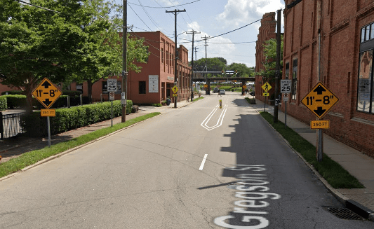

Bridge was raised 8" from a height of 11'-8" to 12'-4" back in the fall of 2019. Well, looks like it is still working as good as always.

It's still more than a foot under legal height (13' 6"). At best. raising it to 12' 4" would reduce the frequency of impacts.

Note that the truck did not strike the bridge. The new crashbeam did it's job protecting the bridge. Not an engineering failure, but success.

Not like he ignored the "OVERHEIGHT, MUST TURN" warning sign.
That sign is terrible. I didn't even notice it at first. Why the hell would you put a danger sign like that in between two green traffic lights and not have them sync'ed together?
It's a design for success system, i.e., the only other way to do this would be to force the lights to stay red until the knucklehead turns, but that would block traffic.
TTFN (ta ta for now)
I would argue that the crash scene blocks traffic much longer than a red light would. Syncing the red light with the overheight sign seems like a decent idea.
The issue is that if the truck is 3 cars back, the red light prevents the cars in front from getting out of the way of the truck, so everything winds up deadlocked.
One slightly complicated option would be to drop a crossing gate and force everyone in front of the truck and the truck to turn.
The problem with that location as I recall from the previous thread is that the junction at which over height vehicles turn is only just before the bridge itself. SO if the lights turn red then the truck can't turn left or right which is what they might do anyway. I think it also points just south of west so probably you can't see the sign against a low sun. Would be interesting to konw what time of day a lot of the incidents took place.
Even from two blocks away you have signs and you can see the bridge in the distance looking rather low.
If you're driving a truck and don't think about your height before you get there they would probably run a red light too.
Many of the trucks that hit the bridge are rental trucks. The drivers probably forget about what they are driving. I run into that problem when towing a trailer, sometimes.
