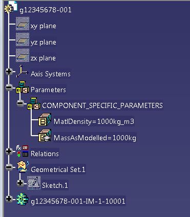

Hi All,
Having taken your advice and lots of other guidance from other forums I managed to achieve what I wanted
As it took me quite a while I thought I'd share my final code to assist other with the same requirements
So what did I do ?
1) I created a ParameterSet within the RootParameterSet to group my two new Parameters
2) I created two Parameters directly within this New ParameterSet (no need for Copy /Paste)
3) Created a Formula linking a User entered Density directly to the MainBody - which updates dynamically as the Solid evolves
The resulting Spec Tree

I hope this is helpful to other forum members :)
