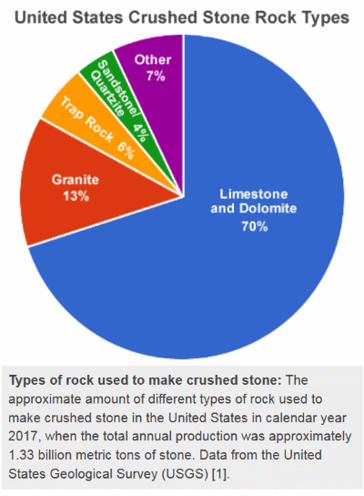

According to this reference, limestone and similar material is used for 70% of the crushed stone in the USA.
