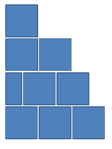

Has anyone come across an example for an arrangement pf blockwork that increasingly tapers towards the base.
No footing.

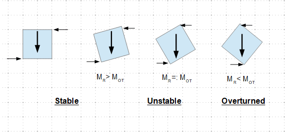

This should be just a simple stability problem, ΣFx = 0, and maintain MR/MOT > 1, at any given elevation.

By the way, I'm looking at the "Multiple depth" case as can be seen in the image just before your post.
If the wall can satisfy the requirement, you should not have rotation problem, because it needs to overcome the friction to rotate. You can experiment with setting a few layers (1 to 3) of block with backfill, and see the result.

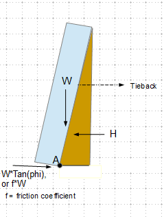

I'm puzzled with the statement above. You are asking the rotation potential of a "rigid body", that does not posses plastic behavior. A rigid body subjected to a horizontal load will have two failure mode - sliding and rotation. Rotation will not occur, if it is allowed to slide. Rotation will occur under two conditions - sliding is prevented by shear friction (µW), and the resultant force falls outside of the pivot point. The whole point of the design of the SRW is thus to avoid the two failure mode with self weight of the blocks, and with the assistance of tiebacks (if necessary).
The bond is an important factor in retaining wall design. However the lack of bond strength is made up by limiting the height of wall, and making the wall more massive. For example, for a constant wall thickness, the concrete wall can be 10' tall, but be 8' for masonry, and 6' or less using dry blocks. However, by increasing the thickness for the latter two, the 10' height can also achieved for the masonry and block walls. Maybe I don't understand your question well, thus my answers are not to the point, but I sincerely hope you are not confusing yourself.
