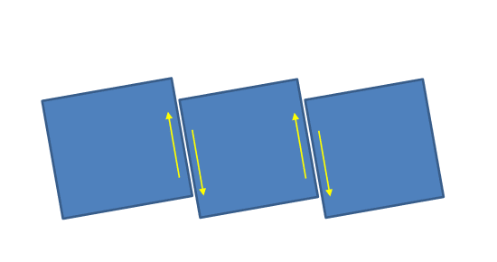

Take the hypothetical case for three blocks.
The overturning restraint offered by three individual blocks is 3.Wi.T/2, where Wi is the individual weight and T is the thickness.
For a hypothetical single block, 3 times the width, the restraint is 3.Wi.3T/2 ... 3 times as much.
What I'm guessing is that the actual restraint is somewhere in between, because of the friction developed.
Is the normal practice to take each block as acting individually then?

For those walls that are several blocks wide in cross-section and which have no tension capacity between blocks, I've only ever seen checks of: friction at the various levels; and middle-third resultant location for full wall height required. But I've never been quite convinced this is sufficient for internal stability, ie no further checks required. Especially for irregular stone where the contact points between various stones may not be ideal from a theoretical perspective.

If block/block or block/soil friction coefficient was below 0.5, the shear stability would govern, regardless of assumptions. The friction values for block/block are above 0.5 from what I looked into last week, for limestone.
Not that I can't do the statics but I wanted to know what the tried and proven method was, with and without mortar. I don't have any knowledge either of experimental or factual evidence ... for that reason I wanted to see a How-To guide.
