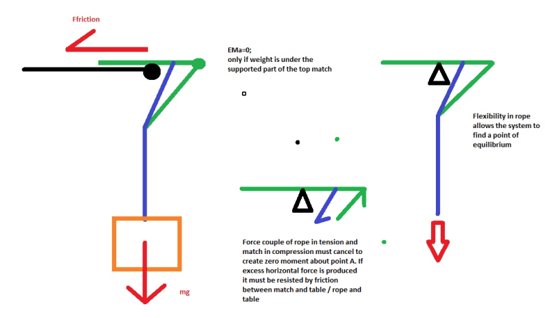

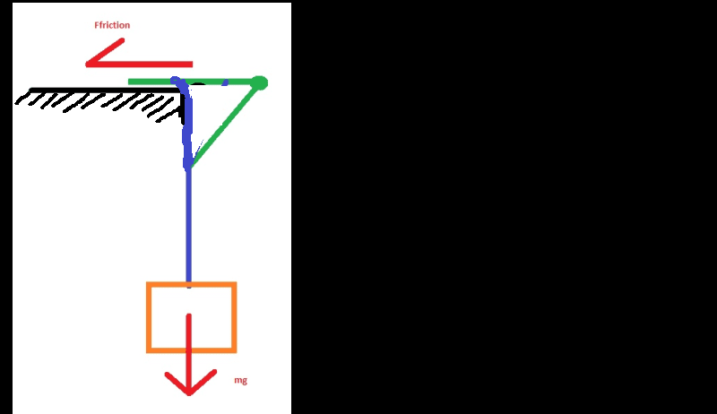

Would anybody agree that the below is accurate? Apologies for deleting posts for some reason I'm not being allowed to add images to an edited post, so I've had to make new ones.

I have copied your sketch and make some correction with paint -brush ..here is my opinion..

Now that I look at it closely. The camera angle is a bit deceiving...the couple working to stabilise the stick works for this particular situation. Now our next challenge...convincing architects that hanging a house on the edge of a cliff using this technique does not work!
MegaStructures has it correct; once the CG shifts to inside the edge of the table, the system is stable. In the first video, you can see in the last few seconds that the left cord is bent inwards under the board, so the CG has shifted to just under the edge of the board. Note also, that the bottom of original match is ever so slightly lifted from the board; the camera angle deceives, but you can see that the shadow of the matchstick is slight taller near its bottom.
