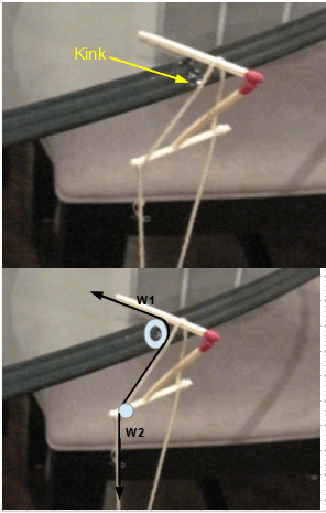

Sep 12, 2020 #1 Enhineyero Structural Joined Sep 1, 2011 Messages 299 Location AU Found this video on the internet showing a cantilevered system without a counterweight. I don't think it is real! https://bilimkocu.com/?p=1952 also on youtube: https://youtu.be/CsmjjOMQg34 Let me know your thoughts....

Sep 15, 2020 #42 IRstuff Aerospace Joined Jun 3, 2002 Messages 44,910 Location US Your kink is irrelevant. Do the exact same configuration with a 16-gauge steel sheet. The results will be unchanged. TTFN (ta ta for now) I can do absolutely anything. I'm an expert! https://www.youtube.com/watch?v=BKorP55Aqvgfaq731-376 forum1529 Entire Forum list http://www.eng-tips.com/forumlist.cfm Upvote 0 Downvote

Sep 16, 2020 #43 Tomfh Structural Joined Feb 27, 2005 Messages 3,691 Location AU It's stable. It's a devils hook. Upvote 0 Downvote
