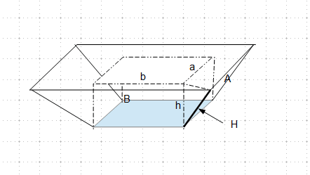

The shape you are describing is a truncated square pyramid. With height h, dimension a, b the square dimension at bottom and top respectively, the sloping dimension of each side can be found using Pythagoras' theorem.
Let c = (a-b)/2
then h' = (h2+c2)0.5
EDIT: If a = 40, b = 20 and h = 75/2 = 37.5,
then c = (40 - 20)/2 = 10
and sloping height h' = (102 + 37.52)0.5 = 39.1

H = (h2 + 2c2)1/2
For a, b, h = 40, 20, 37.5 respectively,
c = 10; H = 40.08 (edge shown in retired13's sketch)
h' is the actual width of plexiglass required for each wall.
N.B. For a good fit, plexiglass edges must be cut to the proper angle.

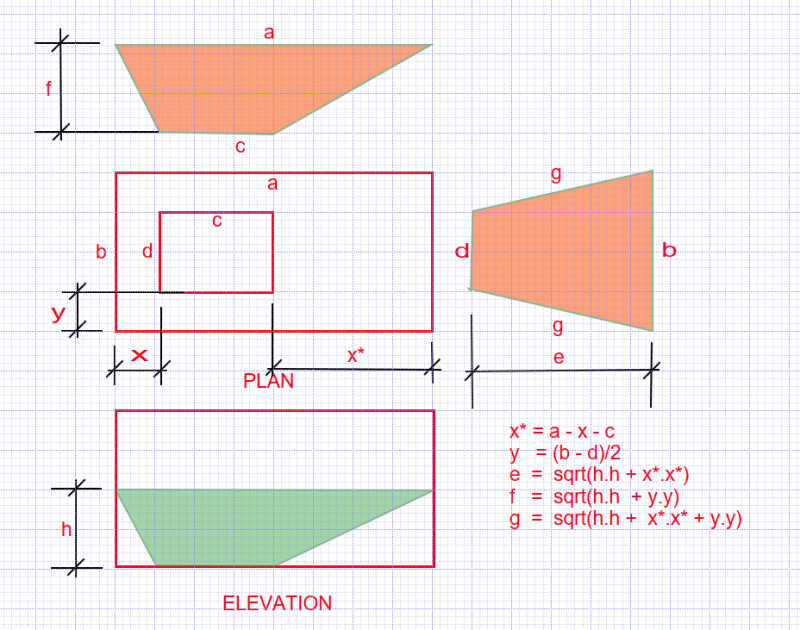

JLNJ - I'm going to have one side longer because of the mountain which is placed on top of the square bottom.

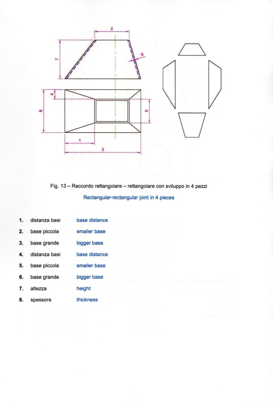

Thank you all for the pictures and drawings! This should really get me started!

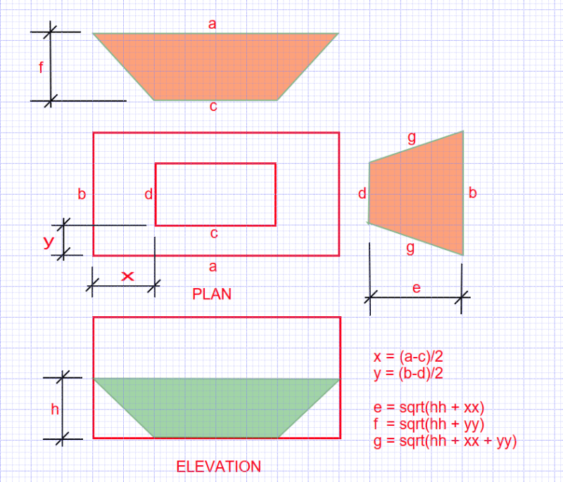

Looks like I misinterpreted the dimensions. Using the dimensions of robyengIT, I agree with his calculation of 'H', the diagonal edge of the terrarium, but that is not the dimension needed to order the material.
Below is a plan and elevation of the terrarium. The truncated rectangular pyramid is shown in green. The plexiglass wall dimensions are shown in orange.
Note: sqrt means square root.
EDIT: Corrected errors in sketch

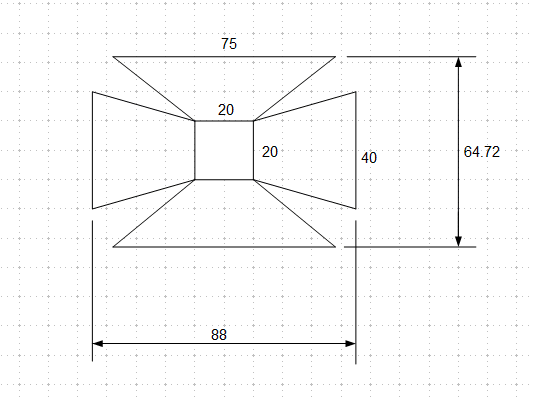

During my job I was using a program to unfold steel sheet : very easy and quick to have result. I am available to give solution (as many time you like, question of 1 minute) according to the attached scheme
