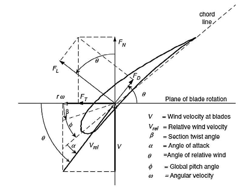

I calculate my angle of attack based on this diagram. theta (relative wind angle) = beta + phi(pitch) + alpha

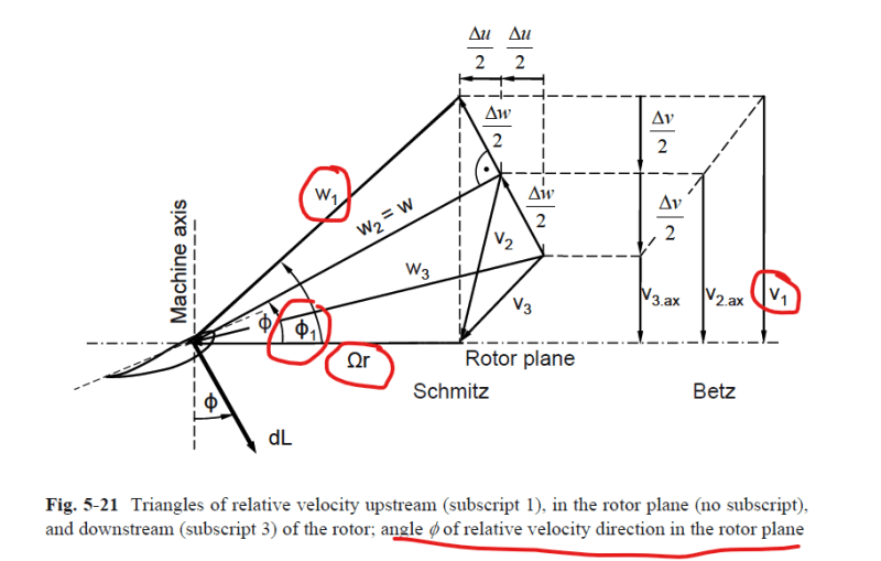

Relative wind angle (here it is phi) is obtained from this diagram from the book by Robert Gasch as mentioned in my original post.

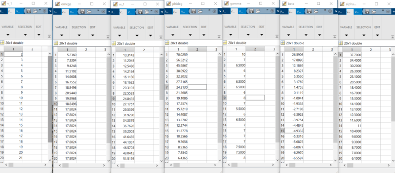

And an example result from Matlab to calculate phi and angle of attack:
And this is an example for the results I obtained:
Here, v_1 is free flow or upstream wind speed in m/s. omega is rotational speed (rad/s) for each v_1. w_1 is the relative wind velocity upstream for every segment of the blade (I divided the blade into 20 segments. coincidentally I simulate the blade for 20 different upstream wind speed). phideg is the relative wind speed angle for every segment of the blade, as seen in the diagram from Robert Gasch's book. Gamma is the pitch angle for every upstream wind speed (e.g. gamma = 6 is for v_1 = 9 m/s). Beta is the twist angle for every segment of the blade. Then alpha is calculated by substracting beta and gamma from phi.
As you can see, for the first 5 segments the AoA is higher than 20. Does this make sense in practice, or at least does my calculations make sense?

I can't claim to have checked this, but don't all BEM, lifting-line, panels and other methods rely in whole or in part on curves that are linear or at least "well mannered functions"? Even with a high-functioning CFD package this seems like a dicey problem to solve.
