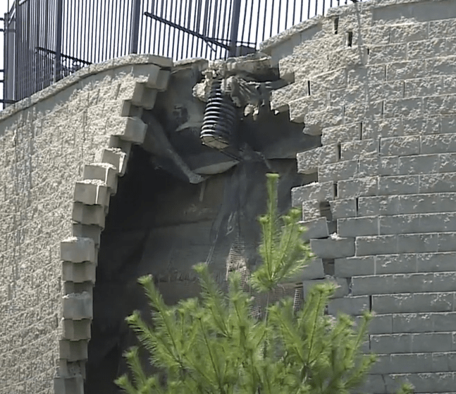

They mention supporting soils being one concern, but the bottom half looks fine.
These things fail pretty often. While they're marketed as being able to be constructed by monkeys, even monkeys need to follow a design and be supervised. Plus there's a lot of details that seem ticky tacky (like anchoring geotextile to the wall with plastic pins) that are the basis for the whole design.
There's a regional Geotechnical Company that gives Brown Bags where they buy you lunch and discuss some of their forensic work. I've been to three or four of them and at each one, there seems to be a segmental wall failure. It's almost always some misunderstanding of the design by the contractor.
The tie backs at exterior corners and there influence on each other are difficult to analyze. I hope the contractor didn't cut them short because they were overlapping.

While this is far from my expertise, that 'retaining' wall doesn't look anywhere sufficient at performing the job of retaining significant earth pressure that could occur on such a large escarpment. I would hope there is more than just that wall holding back that slope.
EDIT: ok, from the above post I would presume they've used geotextiles. Which would also make sense why the failure been seen at the top rather than the bottom. Less vertical load on the geotextile and possibly greater spacing.
I did find it interesting that the only claim was that the wall was structurally sound... Who cares about the wall, it is the mountain of earth behind it that is questionable.
Is it me or does it look like that large pipe might have something to do with it?
Is that a surface drain which just disappears into the back fill?
Or maybe the concrete support for the guard rail?

But the geotex bags look pretty solid behind the wall.
Looks like there is a void there on purpose?
Is that corrugated pipe there for drainage, or a cement sonotube for the railing above? I can't tell, but it looks like it is filled with cement. If it's for drainage, seems odd to just pour water into that empty cavity rather than channel it somewhere towards the bottom.

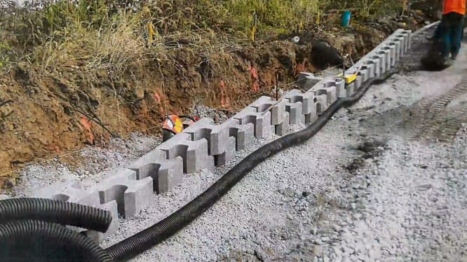

The void space behind the blocks was likely the location of the crushed stone drain that's typically used directly behind the blocks to promote drainage and eliminate hydrostatic pressures.
I'm not familiar with the block type (anyone?) but I don't see a good facial connection for the blocks. I wonder if its purely friction based instead of using a lip or fiberglass pins?
LittleInch and Mac - that's the foundation for the fence post. A questionable arrangement itself given its proximity to the wall.
I'm guessing that either the surface was not sealed around the post foundation or that it was damaged possibly by a vehicle backing into the fence post.
That would allow rain water to enter and saturate the fill behind the facial blocks.
I think that the void is a result of the fill that was originally behind the blocks now being on the ground below.

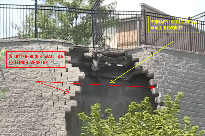

Is this wall comprised of a primary structural wall (internal) and an external segmental block 'veneer' for appearance?
Basically yes. The segmental walls often don't have mortar, only their weight and the interlocking connections. The lack of movement of the backfill, which looks like a set of geotex bags, seems to have held.
It's the lack of our failure of drainage that usually kill them like this.

It's actually geogrid that typically gets installed between every 2 to 3 blocks to reinforce the backfill.

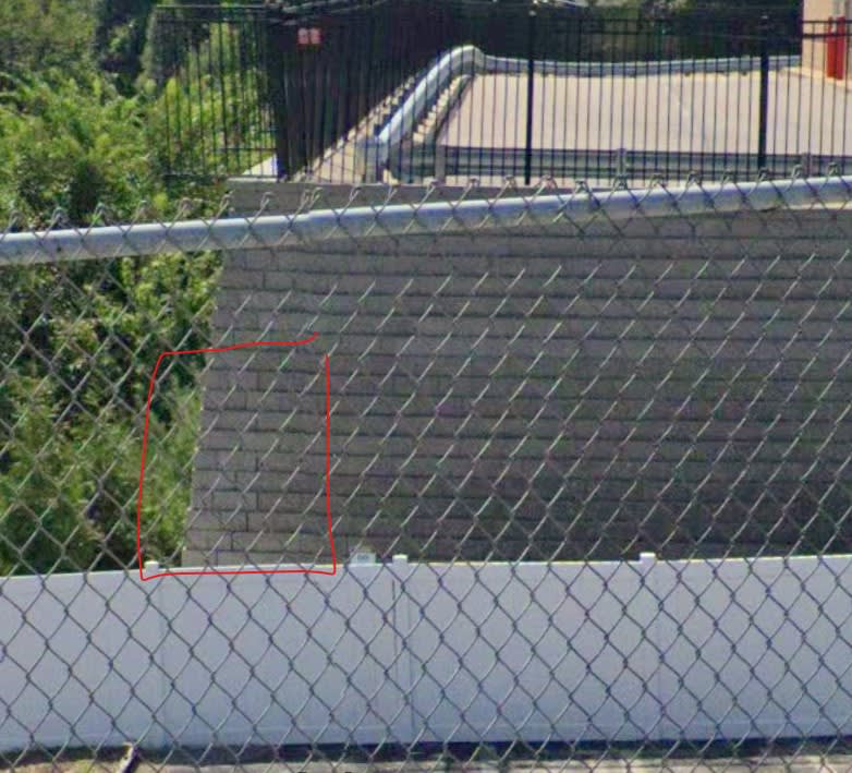

The same wall *appears* to be having issues at the 90° corner closer to the highway. Looks like some larger than normal vertical joints b/w blocks.
