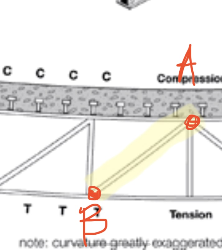

Forgetting roof trusses which are subject to stress reversal/wind uplift - I would have always braced the bottom (tension) chord Of a floor truss, at least at a couple of locations, so that the internal compression members are restrained - or at least held by a bottom chord capable of laterally spanning between the restraint points.
For me, if the bottom chord has no restraint then the Effective length of the internal diagonals Is unquantifiable.
However I’ve recently seen some trusses where the bottom chord is not restrained And I doubt very much that the bottom chord can withstand any lateral kick.
What are your thoughts? Random photo below just for reference.

Technically, the bottom chord doesn't need to withstand a lateral kick from a stability perspective. Rather, it only need to return to it's original position when you're done kicking it.
So if we agree that the bottom chord doesn’t need to withstand lateral kick, the effective length of the strut highlighted below would be difficult to calculate correctly since it could in theory ‘whip’ laterally? I do get what you’re saying that its in tension so could in theory pull itself back into line... but I’m not sure how I could argue that in court if I did have an issue.
Taking the example of a non pre-tensioned bar as the bottom chord - Historically, in the late 1800s over here we would have seen countless iron bar trusses which have no bottom chord restraint. I always wonder how you could really justify any assumed effevtive length of the internal diagonal strut.
Point A below of course is restrained in position and direction, point B however is not...really..kinda..sorta..
Also - just to note.. the example image above is purely for reference. This thread has nothing to do with composite trusses or longitudinal shear.
It's super easy to calculate. K = 1.0; KL = compression web length. Using bifurcation methods, it's a binary thing: either the panel point kicks out... or it doesn't. The reality is more complicated of course.
I don't believe that I did say that. The caternary argument certainly holds water but only if the caternary itself makes its way out to some point that is itself laterally stable. The stability mechanisms that I'm proposing for most of these situations would be:
a) the restoring force created by bottom chord self weight for heavy trusses and/or;
b) a torsional connection to a supported CIP slab where the details of that would make sense.
