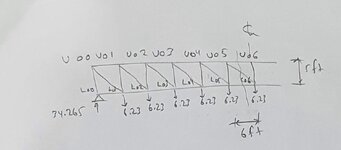

Hi all,
For a Pratt truss, lateral support is provided by a transverse U-frame consisting of the floor beam and truss verticals. What about a Warren truss? It doesn't have verticals.
BAretired said:
The cross braced members would be considered tension only as they appear slender enough to buckle under a compression load.
Can cross brace members be ignored in gravity load analysis if they were to be considered as tension only? If so, the support structure in the foreground would seem like the attached image, isn't it?
