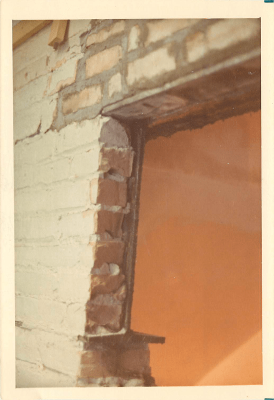

Do you think the steel beam is even required, if the wall below was there before?
Definitely not... masonry infill... I did add a strip footing at the bottom. Top flange was lintel... about 50 years back when I was a rookie.
Dik
dik,
You know, I think it would be much fancier, if you can cut out a triangular/circular arch that doe not require lintel, and I would have given you 5 stars on that:) Actually I think it is doable (in my wild dream), what do you think?
It's possible... but it was a 10 or 12 storey building at the lower level... I wanted to have the top flange as a tension tie... was for a 6' wide door opening going from the street to the basement.

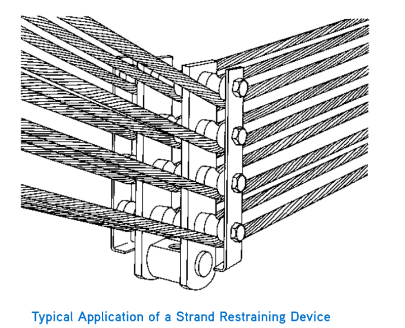

Thanks. We had anticipated push-back from the peer-review - which we did get. I researched the restraining devices used in precast pre-tensioning applications for harped single strand where less than 2" dia pins/rollers are used with larger angle changes and no reported issues since their first use dating back to the late 1950's - see image below. however, our case was a bit different as we had 7 strands in a bundle over 3 layers (3+3+1), not single strands.

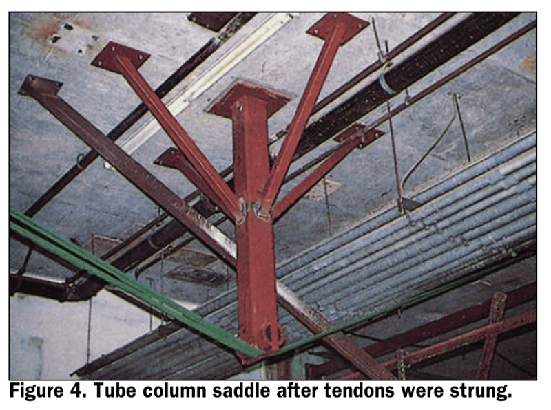

I also checked on some of the other eternal PT projects I have done and researched other external PT projects done in the US, where small dia pipe sections were used as external deviators. For example: one of Bondy's projects from a few decades ago:
When we considered the embedded existing tendons and their 'existing curvature' the re-profiled tendons had an effective radius/arc considerably larger than the point-contact of the pipe diameter. We decided upon a 3-½" OD pipe (0.6" wall and grout filled) and monitored the tendons at the deviators as we hydraulically re-profiled the tendons and there were no issues - i.e. no sheathing splitting, no wires crushing/bulging, no strand flattening.
