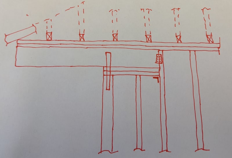

I am always used to seeing the cripple studs installed above the header and below the double top plate. I think that for most scenarios this would be fine as the cripple studs can transfer the load from the top plate to header. However, what if you have a significant girder truss concentrated load coming down on top of your double top plate. Studs at 16" o.c. and trusses at 24" o.c. What if truss lands right between the studs? How do you address this? Would it be better to have the header beam installed directly below the top plate with cripples below?
I thought about that but was worried that the Contractor might miss the detail and ignore it. If that is standard practice then I could show that
Or maybe on the roof framing plan show a post beneath all girder truss bearing points regardless if there is a header below or not?
I always show posts below girders down to top of lintel. I even call it off as "provide xxx ply 2xwhatever post down to top of lintel"
That way there's no confusion.
It's standard practice here to add the extra cripples. Will you be doing inspections on this? If so, then you can make sure they get it. If not, then it's up to you. I've seen some people detail headers just below the top plate no matter what - some framers like it because they can get the walls up faster, and it gives some amount of flexibility if you want to use a taller window or make adjustments after the fact. It's the exception around here, though.

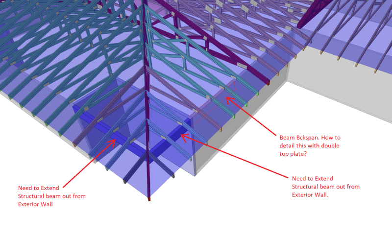

This all makes much more sense. I do have another scenario though. I need to cantilever a 5.5 x 15 glulam out from the top of the exterior wall. I need a backspan on the beam but the level of the beam would be flush with the top plate. How would you detail this around the top plate seeing that it is at the same level. I feel as if I've seen this before with gable roof extensions but can't seem to find anything.
For that last picture, can you make the truss cantilever instead? That puts the complicated part onto the shoulders of the truss designer and your two beams could be simply supported instead of having one cantilever.
We tried. The truss manufacturer couldn't make it come out. That hip truss has almost an 11 foot overhang. That's why we added those support beams.

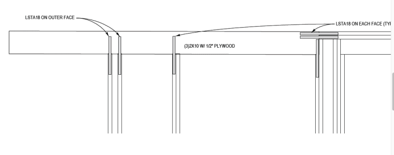

This is what I did on a recent project...
Here's how I'd probably do it. I drew backspan is too short because I was lazy. =)
Running your double top plates out to the corner makes sure it's all tied back into your normal shear wall load path, but it adds depth to the overhang. You also could have top of beam equal top of double top plate if you stop the double plates at the start of the beam, and just strap the beam to the top plates.
Thanks guys. I ended up going with the Beam flush to the top and strapping it back to the double plate.
