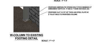

Cleaning up another engineer's mess. Previous engineer showed insufficient data, such as connections of existing roof framing to I beam, and how I-beams connect together and at concrete base. Their diagram, they have roof framing flush with I-beam, i.e. using hangers. I want the proposed flat roof rafters, and existing trusses to bear on top of the proposed I-beam header and then use a 2x6 Nailer installed on top of the I-beam header, matching the web distance, and use some sort of hurricane strapping & blocking to connect everything together. What have you done for these, I've always used wood headers such as lvl. See attachments, thank you.

I haven't reviewed or verified your design in detail, but at first glance, I would recommend that you draw traditional 2-D details instead of your fancy 3-d BIM model. For example, your beam-to-column detail is essentially unintelligible because you can't see the actual components being referenced by your leader callouts. It leaves a lot of room for interpretation and error. Your drawings are an improvement over the other guys crap drawings, but they still leave a lot of room for improvement.
Plus, is this proposed, as you say in your drawings, or existing, as you say upthread?
Thank you for the critique. I do some details in 2D, I just like the look of 3D. One of the issues I've had with 2D, is you don't know if its "going to fit". If you draw it all out in 3D, it leaves out all questions. Yes, this is after the fact, but I still need to differentiate between what was there before items were constructed. what other term to use than proposed?
You may like the look of the 3D model, but I guarantee the contractor won't.
I typically use "new" instead of "proposed" I like my drawings to have as few words as possible. No need to say "strong tie" - Simpson is fine. No need to say "thick" on the plates - everyone knows what you mean.
Since you are calling out the steel W-sections properly, I would not include the overall dimensions. If they are qualified to handle steel, they should be able to figure that out.
I would not call out 2-2"x6" since the correct designation is 2x6. I might show it as (2) 2x6s or two 2x6s. The more numerals you show in a row gets confusing for me to read. I single note saying "all lumber is dressed or S4S UNO" would cover dressed versus actual.
I try not to label things as "New" or "Proposed" on drawings, only existing. The implication is that if it's not labeled 'existing' it is new. That way, if I miss such a label, it's something the contractor doesn't have to buy rather than an omission that results in an extra charge.
Also, I'm a big fan of using 3D or isometrics for context. BUT...they should supplement traditional detailing, not be the primary and especially not the sole method of conveying the design intent.
