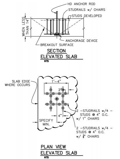

I suspect you'll need some reinforcement to carry the 800kN of load, vertical stirrups covering the breakout surface anchored around the main reinf top and bottom. This then becomes a matter of designing this reinforcement as anchor reinforcement, you won't be reliant on the concrete breakout surface.
But I think I'd check the anchor plate in a similar manner, bearing on cantilevered plate. It's a bit like an upside down baseplate in a way, so you'll find plenty of similar approaches on baseplates which lend creedance to what you are proposing.

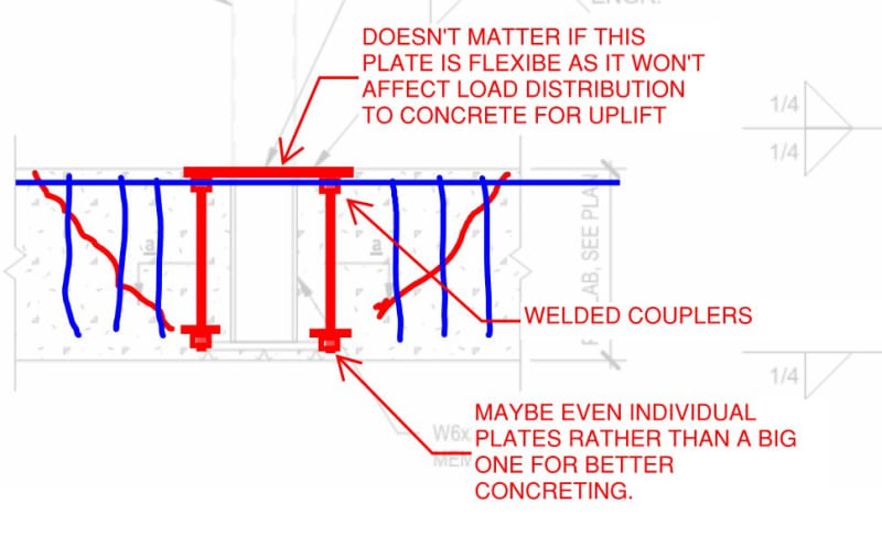

I like something like shown below at a heavier scale if the numbers can be made to work. Maybe stirrups instead of studs at your slab depth and run four anchor rods down to a very thick plate at the bottom. I'd think this would give you better concreting in the area of the connection as well.
Or something like this taking advantage of:
1) The flexibility of the upper plate doesn't matter much for uplift and would allow you to spread things out legitimately.
2) If you look at the research on regular punching shear, you find that the delivery of load is, in fact, not uniformly spread about the perimeter. Rather, it's localized at the corners of the columns (for squarish ones at least). I think you could lean on that to justify that the use of individual plates at each bolt would still give you the big punching shear capacity. Then you wouldn't have that spalling potential below the plate so much.
