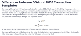

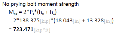

Hello,
I have a 4-bolt unstiffened end plate connection that satisfies all DG-4 requirements except for the thick plate behavior criterion. My understanding is that the criterion to be met is:
Any clarification or suggestion on how to resolve this will be very much appreciated.
thank you.

Thicker plates would resolve it, you're probably limited by the supporting flange now. So a flange doubler and stiffeners is your next bet, if you can't upsize columns
Thank you. W18x119 works but that is a big jump from W16x67.
