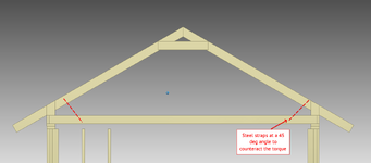

Hi guys,
I'm building myself a garage and I wanted to get your opinion on wall thrust and the rafter and wall plate connection. All the dimensions are in mm.
As you see on the picture, I want to connect the rafter to the floor joist using a 45x145 mm material. I was wondering is there a concern that the outward thrust that the rafter exerts wants to bend that piece outward? At the moment I have the collar tie there to prevent the rafters from pushing outward but what would happen if I remove the collar tie? Would then the outward thrust bend the rafters apart?
Appreciate all thoughts
Here is another option that is a mixture of both. I have seen this done many times in the past 20 years whereas I rarely saw it 30 years ago. Whether you use 1 or 2 top plates depends on whether rafters and joists are aligned. Not aligned is generally 2 layers of plate. The rafter attachment still has to be strong enough since there is thrust. I think there may be a Simpson connector that can make the attachment.
This is common in my area. No Simpson connectors anywhere. Have never been able to get the numbers to pan out.
The reasons are simple. Because i want to have the "attic" space as high as possible. Also i have all the material already bought and the walls are up and now im in a spot where going back to this standard framing that you propose requires quite a bit of effort. I totally realize that the standard solution with rafters lapped to joist is sturdy and preferred.
So that's why i posted the question that would the solution with the vertical blocks work or what to look out for to make it work.
If we're looking at this sketch:
The basic procedure is:
  1. Calculate the thrust/tension force in the horizontal piece.
  2. Design a connection between it and each rafter.
  3. Design the rafter to resist the thrust force and the forces due to dead, snow, and any other applied loads.
  4. Design the vertical piece to transfer gravity and other loads (like wind uplift) to the wall below.
What works and what doesn't work comes down to the location of the horizontal piece (lower is better for less thrust/tension force), member sizes, materials, rafter spacing, and the magnitude of snow and other loads. There's no simple rule of thumb for what works here. Do the calculations and then report back for more meaningful feedback.

I have never calculated one, but have seen it on REALLY old houses and newer ones. Time you put up to 4 toenails into the rafter cut, can't be much strength left. This case may work since the rafter is short.

I think friction is doing a lot that is not accounted for.

Better yet, model the structure. Like the old days when we were asked to create a free body diagram to prove one's approach to a solution. When I do that on this structure, I see two pins at each rafter to ceiling connection yielding an unstable structure.
Why are we trying to reinvent the wheel here? This is an incredibly basic and well documented type of construction. Just build it like a normal light frame wood garage. No need for funny little rotating blocks. Just tie the rafters and be done. Or put in a ridge beam if there's something weird going on at the eaves that can't be changed to make normal construction work.
If the OP wants to do something unique, they should hire a professional to advise them.

You are really confusing me with this statement. You want attic space as "high as possible" but you keep wanting to put a tension tie at mid-height of rafter. I assume you intend to use the attic for storage. I have crawled more feet in an attic than I crawled as a toddler. The last thing I want is an obstacle every 2' to negotiate. I would do whatever I could to eliminate the obstacle if I intended to use the attic for something.

I assumed OP meant that they want the garage ceiling as high as possible. The attic space is barely accessible even without framing members at midheight, so I don't think that's what they meant.
I agree with pham's advice above. OP is making this way harder than it needs to be. Best to hire a local engineer.

That is still confusing me. Is the 'floor joist" he shows not present as you go across the garage? If it is present, the ceiling height is still the same with or without the rafter on the wall or the tie.
