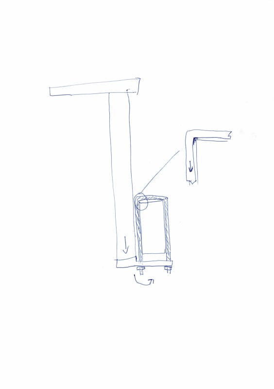

Looking for some insight on a failure of a Stainless Steel Square 1/2" U bolt. 3 1/2" legs and 5 3?4" wide inside. Rated for 5000 pounds capacity with a 20% over factor so 7000 pounds.
Background: this is one of 4 U bolts used on the lifting bunks of a boat hoist that hold up the boat on the lifting frame. Overall capacity of the lift is 4000 pounds ( these U bolts are normally used on a 5000 pound capacity rated boat lift) Boat wet weight is 3500 pounds. The U bolts in questions were brand new last year, used for 5 months on a boat lift in fresh water. The U boats and bunks were removed from one lift to install on another lift this year. On the second day of the boat being loaded on the lift the failure occurred on one of the four U bolts about 45 minutes after the boat was put on the lift.
Do you think the tooling mark creases or cuts into the inside corners of the U bolt contributed to the failure? ( since the failure point was at or very near these tooling marks)
Would the angle of the single U bolt when mounted, with the upper and lower portions not being vertically aligned with each other, have any affect on the load contributing to the failure?

Angle of the lifting bunks, U bolts were offset at an angle about 3 1/2" off center due to 5" cross-member tube and 5 7/8" inside U bolt width.

It looks like the angled installation puts a twist load on the ubolt. There would be combined twisting and bending at the bend. The nuts may not have been tightened enough to create enough friction force to carry any the loads. I don't think ubolts carry side loads very well. Their ratings are tensile loads.

Yes - It looks to me like someone is trying to get these square bolts to fit exactly over a square beam / channel / box section. So if the inside edge to inside edge of the U bolt was say 4 inches, then it was designed to fit over a 4 inch wide beam/flange with absolutely minimal clearance. Otherwise any gap between the edge of the beam and the corner you will get a significant bending moment on the inside edge and truly horrendous stress concentrations there. Also as you can see from the failed sections the diameter of the bar is reduced where this notch has appeared.
"Would the angle of the single U bolt when mounted, with the upper and lower portions not being vertically aligned with each other, have any affect on the load contributing to the failure?"
Also yes but that single picture is unclear as to how the boat "lifting bunks?" are actually attached to the frame and how , if at all, these are tightened. Needs more pictures or a drawing / side on view. Are these bunks designed to slide to fit the particualr boat? Is there any tension on the bolt before the boat is lifted out of the water? The existing bolts seem to have scrape marks on them?
I diodn't quite understand this bit "Angle of the lifting bunks, U bolts were offset at an angle about 3 1/2" off center due to 5" cross-member tube and 5 7/8" inside U bolt width. I didn't quite understand this bit " Can you explain / draw what you mean?"
Where is the load path?
Does the bolt go through the holes visible in the lifting bunk to adjust height?
Even if not the load would appear to be concentrated on one side only so I'm far from surprised this broke. The moment from only one side being loaded will create bending forces in the bolt and result in virtually all the weight of the boat being taken in one corner of the bolt. Poor design IMHO. Better to have something in shear than tension like this. Did it look something like this in section?

OK, i think I understand things better now ....
My suggestions:
1) Buy slightly larger diameter quality SS bolts (5/8") without the corner notch and replace the old bolts OR
2) Use TWO 1/2" bolts side-by-side to support your beam and redesign the hardware OR
3) Redesign the support structure where the moment is taken out of the square u-bolt by either a brace or use of two robust flat plates (sandwich) and interconnecting bolts.

Any bending moment on that 90 degree angle end will result in high stress concentrations at the root of the V notch. Not to mention reduced diameter of the rod or decrease in torsional strength.
I would say it's not in the slightest bit effective.
