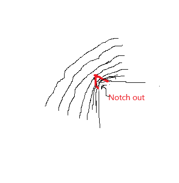

Looking for some insight on a failure of a Stainless Steel Square 1/2" U bolt. 3 1/2" legs and 5 3?4" wide inside. Rated for 5000 pounds capacity with a 20% over factor so 7000 pounds.
Background: this is one of 4 U bolts used on the lifting bunks of a boat hoist that hold up the boat on the lifting frame. Overall capacity of the lift is 4000 pounds ( these U bolts are normally used on a 5000 pound capacity rated boat lift) Boat wet weight is 3500 pounds. The U bolts in questions were brand new last year, used for 5 months on a boat lift in fresh water. The U boats and bunks were removed from one lift to install on another lift this year. On the second day of the boat being loaded on the lift the failure occurred on one of the four U bolts about 45 minutes after the boat was put on the lift.
Do you think the tooling mark creases or cuts into the inside corners of the U bolt contributed to the failure? ( since the failure point was at or very near these tooling marks)
Would the angle of the single U bolt when mounted, with the upper and lower portions not being vertically aligned with each other, have any affect on the load contributing to the failure?

I agree with LittleInch ... The V notches are a defect and not a "product enhancement"
Review the information on the link that I posted above by Portland Bolt.... They take extreme measures to ensure that there is a minimum required diameter at the corners of their products.
The notches are there because some shop in China can more quickly get more bolts out the door if they bend these against a sharp corner. There are no quality standards and they are being paid by the ton ....
Again, square u-bolts are a bit of a mongrel fitting that do not really follow any ASME, ANSI or MSS dimensional, product or quality standards.

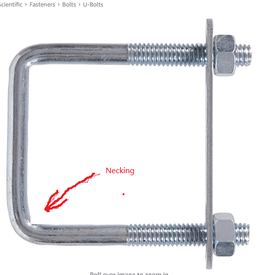

In my opinion, the purpose of the notch is two fold - 1) easier to bend, 2) the stresses in the remaining area tends to be more smooth.
Stress concentrated at the inner face due to necking.
we can all agree that this the wrong tooling to use.
should be an Ibolt or bracket, to prevent moment, that is the main reason it failed.

I think the bend in the ‘u’ bolt is detrimental, with such a sharp bend on the inside it’s likely the outer diameter of the bend would have developed cracks which would reduce the bolts capacity to carry load.
When bending round bar, a specified inner radius must be maintained, and the force shall be applied gradually. Bend bolts/bars serve many functions, important thing is to follow manufacture's recommendations in bolt selection and use, pertaining the application. Everything will fail, but what is the percentage and frequency need to be addressed before scrap an idea.

Looking on this site it recommends inside bend radi of a rectangular ‘u’ bolt should be at least twice the diameter of the bar, looking at those pictures here those radi are nothing like 2x dia.
However the bend radius is only one part of the problem because as already stated in other posts we have suitability for the job, loading on the bolts and the bolts have been re-used so they might of been over stressed the first time they were used which really means they should have been re-placed.

If I wanted to be philosophical about this I wouldn't say this was a manufacturing defect. The entire idea was so flawed that it can only be described as amateur. They were trying to bend a bar over what was essentially a chisel, instead of a smooth die with an actual radius. There's a fair chance it was cracked when it left the basement, er, factory.
These are bent in a press brake, I've seen the exact same notch in rebar as well. I always wondered why the rebar didn't break, so hey, it must've worked, right?

I did some more research. It seems the notches may be to "weaken" the bar in just the right locations to get the leg bars at the desired spacing. Similar to the notches sometimes seen at the edges of sheet metal to make sure the metal bends in the right place.
