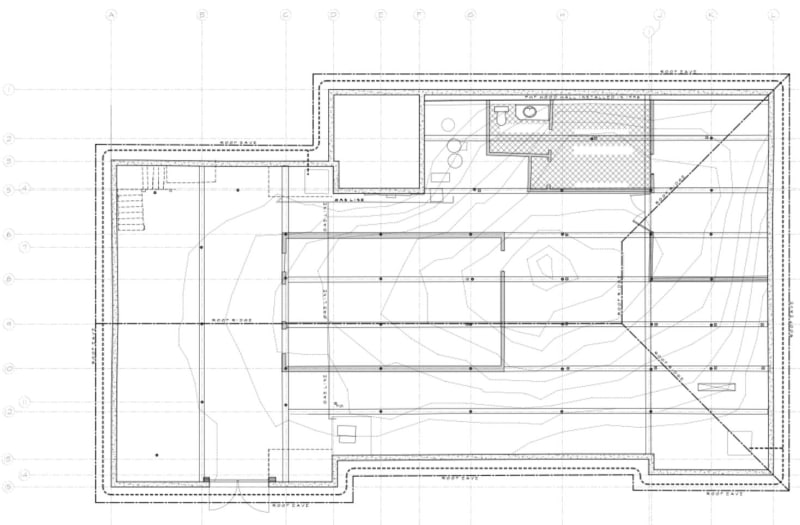

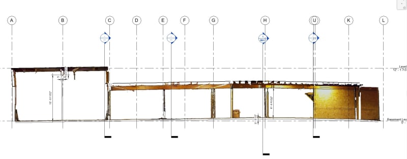

Here is an example scan as mentioned. Keep in mind this is not a picture. The scanner creates colored points and collects enough points that the data looks like a photo when done.
From the data you can create a contour map like the one below.
This was one of the worst slab on grades we have scanned. It has heaved over 9". Here we could use a contour interval of 1"'s and not 1/8 ths like typical.
Brad - that's pretty neat. What kind of scanner is your company using, and what kind of file output does it deliver? What about post processing requirements?
We are using a TopCon GLS2000, but would like to upgrade to the new Leica RTC360. Leica and Faro are the more common scanners. Registering scans together can take some time if you have lots of scans, but the new RTC does a pre-registration as you are scanning since it tracks the scanners position. We hope that will speed up the process of registering the data. The scanner is essentially collecting million of points, and 360deg photographs. The points are colored automatically based on the photographs. At the end of this you have a point cloud that can be read with Autodesk Recap, imported into Revit, CAD, or many other packages that can handle very large point files. The top image was taken from the Revit model. Converting the data into a solid model after this can be tricky. There are endless software solutions for different aspects, and you may require many software packages when involved in multiple industries. In a case like this one could easily figure out the wall deformation by measuring in Recap to find the wall bow.
There are some other nice scanner solutions on the market too that are much more cost effective. The progress being made in photogrammetry is quite impressive and it is quite a bit easier to work with. The Leica BLK360 can collect data that can be accurate to within 1%. This would not work well for this case if dealing with long distances, but if you are wanting to create decent general arrangement drawings for a reno, it can be a great option.
