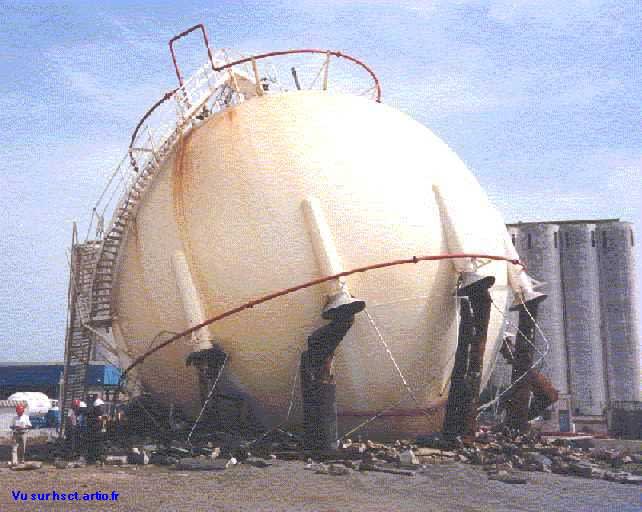

The following picture depicts collapse of an old spherical tank during hydrotest.
