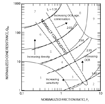

The general trend however is as you get closer to negative values for normalized penetration resistance, the Q is low and the Fr is high, that puts you on the bottom right of the chart below showing Ic contours.
This would put you in zone 2 identified as organic soils - clay according to the table below
If you truly were in a very soft clay you should expect to see a large pore pressure response due to the low permeability.
