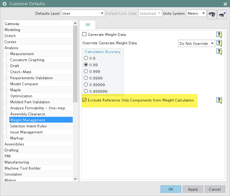

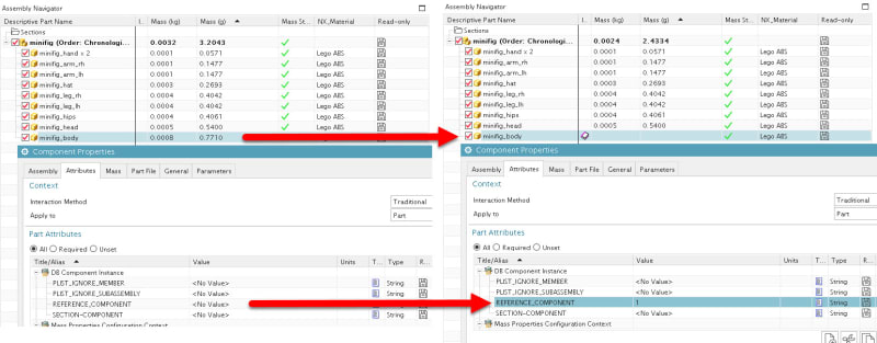

Some parts are added as "reference only" in the assembly. Total assembly weight is including these reference only parts also. Is there any setting to exclude all reference only parts from assembly weight. If some body know the solution please advise me. Thank you in advance.
Assuming that you're setting a value for the system attribute REFERENCE_COMPONENT which will mark the component as reference only (as per image below from NX1911).
You also need to make sure that the customer default for exclusion of reference only components is set (see image below from NX10).
You didn't mention which version of NX you're using, so search the customer defaults for EXCLUDE REFERENCE as the location as to where it's found may vary.
