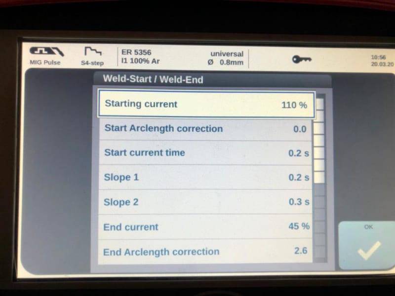

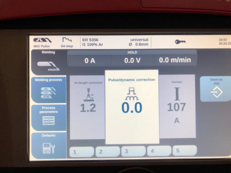

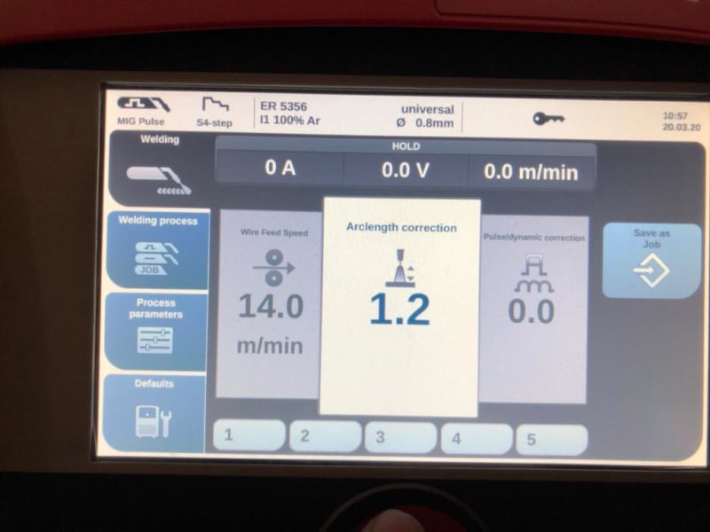

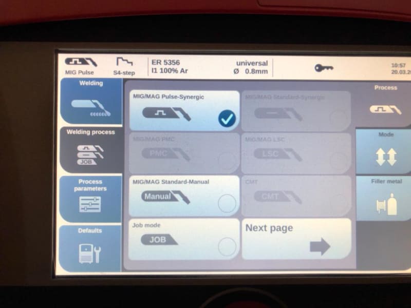

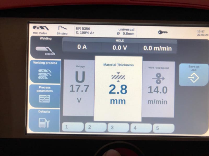

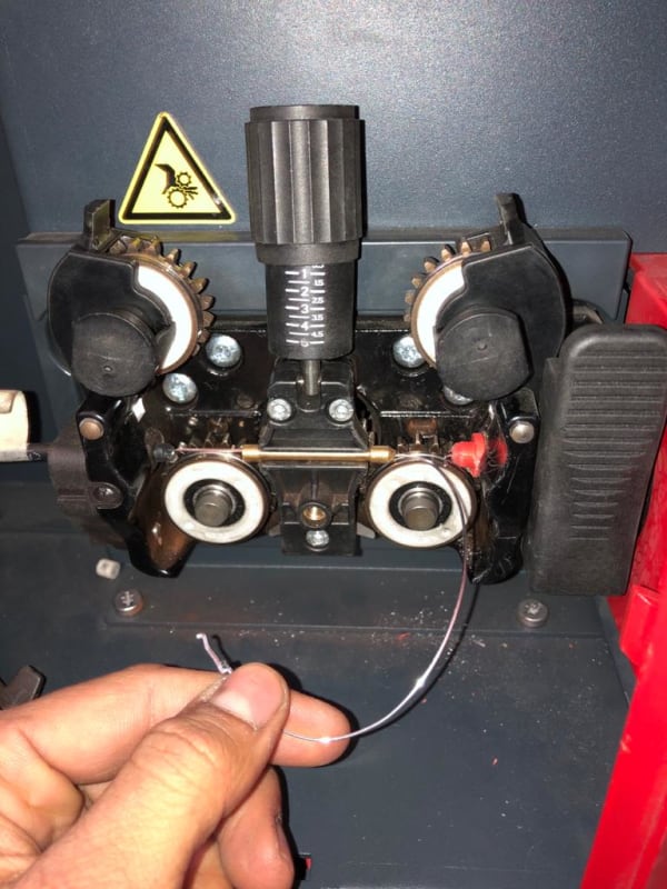

I am trying to weld 0.8mm Aluminium wire with fronius tps 320i,every time i try to weld my tip get burned and bird nesting occurs at the back, my settings are according to weldconnect application which describes 2.1mm material thickness,10m/min wire feed, 85amps current with synergic pulse welding process, there are two more process namely ARC LENGHT CORRECTION & PULSE/DYNAMIC CORRECTION I AM NOT FAMILIAR WITH THEM PLEASE HELP ME WITH THIS I BEEN TRYING FOR TWO DAYS.
THANK YOU VERY MUCH

Arc length correction (-10 ... +10) will slightly decrease/increase the voltage, giving a shorter/longer arc.
Dynamic correction (-10 ... +10) will only work during pulse mode (affecting the droplet formation at peak current).
If your wire burns during starting, likely your start current is too high. Should be no more than 110 - 120 % of your welding current.
Adjust the start current time (in sec.) accordingly.
I have no experience with wire feed speed/current relationship of 0.8 mm Al wire, however I think 10m/min might be a bit high if you're aiming for 85A.

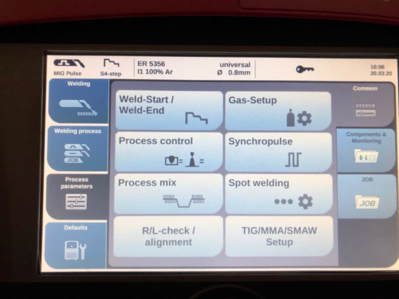

There is also a start arc length correction if I'm not mistaken. I'd leave that alone (-10 ... +10 => leave at 0)
Another possibility is that you have a very aggressive upslope.

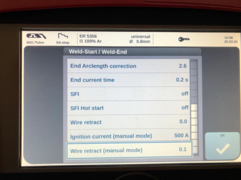

Also, you you have SFI (spat free something) on your machine? There is also a hotstart function that comes with SFI, I'd turn that off also.

So you are pulse welding (I didn't catch that in your opening post), using a mechanically monitored/driven pulsed wire feed system (that I didn't know about).
Now I have no idea how that would work with a push/pull system or spoolgun, but now I understand (and concur with) IM's remark to stay away from the fronius MIG/MAG welding machines.

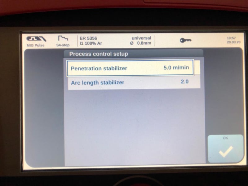

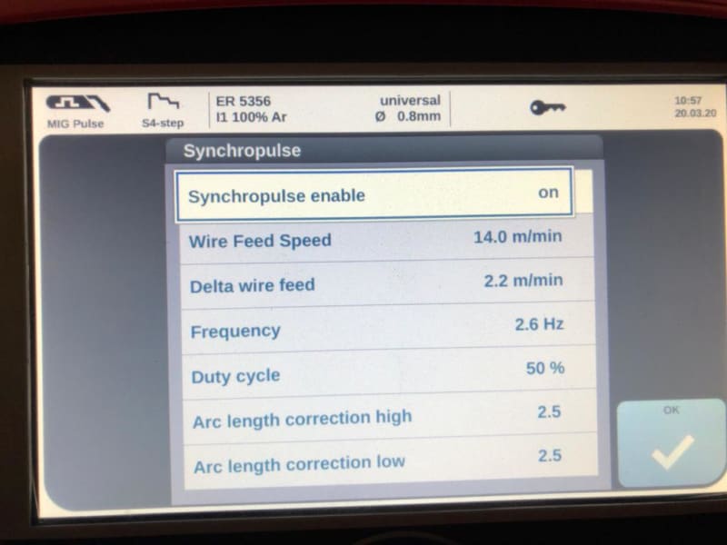

The settings that are on the screen look good, however there's an ignition current of 500 A, that sure looks suspicious, and I'm not too fond of the 2.6 Hz. Incredibly annoying for the welder.
Can you try, in no particular order:
- changing the 500A ignition current, but I'm not too sure what that does in manual mode?
- a bigger wire (together with the correct drive rolls, liner, contact tip (eg. 1.2A for aluminium!),
- not pulsed welding (so a continuous feed of the wire),

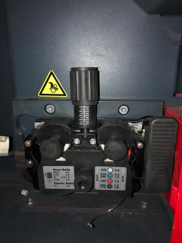

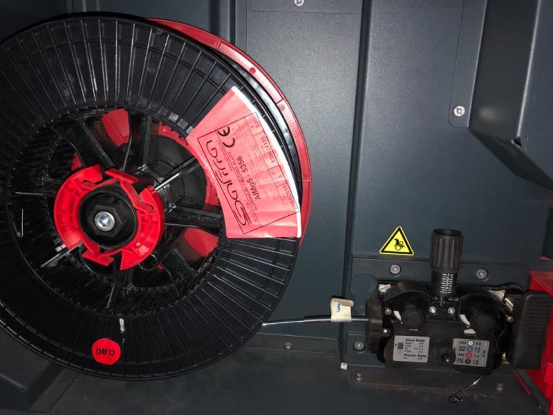

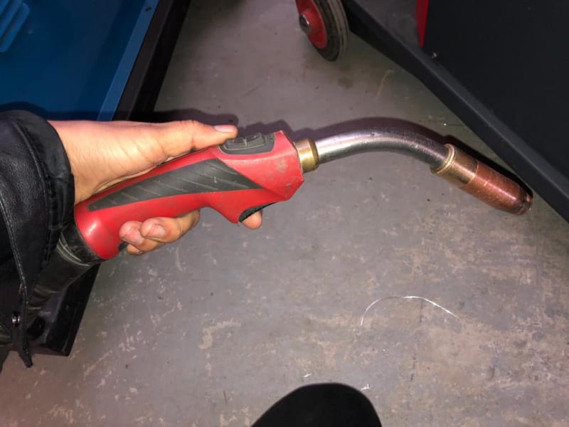

- Showing a picture of the "free" wire run between the drive rolls and the entrance of the liner/torch cables (= the place where the birdnesting happens)
kingnero ı am stuck wıth fronıus due to company order ı have to master thıs machıne wıth 0.8 mm wıre and start to weld chassıs
OK, so start with what you can change...
For what it's worth, the set-up of the drive rolls looks good from here.

Are the drive wheels and liner the correct ones for your wire diameter?
Is the wire brand new or has it been sitting outside in the rain for weeks?
How far away from the work is your torch?
Where is the end of the tip relative to the end of the cup/
Are you using a teflon coated liner for welding aluminim? They can help the wire feeding quite a bit. Assuming your issue is really wire feeding, not parameters, then use what Kingnero said: - a torch with an as short as possible cable run (max. 10 ft/3m, preferably shorter)
