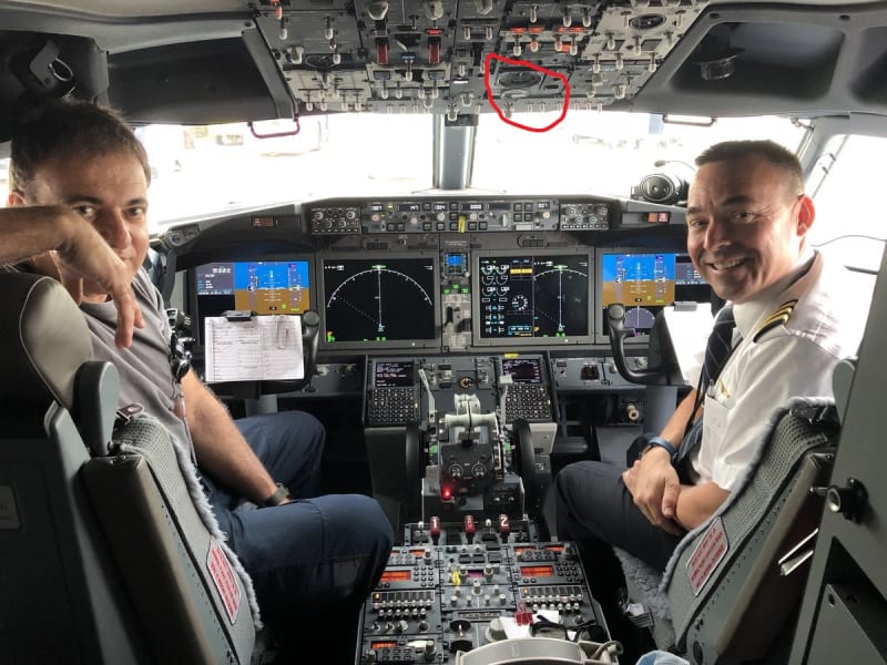

Just as an example this is my current workplace.
The red circles are the system killers.
Next to the clock we have Sticker shaker and elevator trim kill buttons. Stick shaker I have covered, The trim if it runs for more than 3 seconds continually then a aural alarm sounds and that button lights up. You press it and the trim system dies.
Next along to the right is Gpws test buttons and mute. Which we can use to kill certain EGPWS warnings which occur when we have flap jams and various other none normal configurations.
The 4 horizontal buttons are for killing the spoilers and rudder pcu's and de pressurising those systems.
But all the killer buttons are directly in the field of view you need a fraction of a second to identify and kill and your eyes hardly move away from the primary flight instruments.
The blue are the attention getters to get you to look at the CAP panel one for critical warnings and one for cautions. The black square just above the windows and below the light switches is where all the warnings and cautions come up and we call the CAP . Its normal to operate with this black ie no lights showing. look there and you see what light is showing then look at the panel index in the back of the QRH and it takes you to the right page.
Now the 737 max grandfather cockpit.
It has the caution buttons alerting you to something wrong at the ends of the glare shield but no centralised CAP panel to see what's wrong, you have to search round the cockpit to see which system is showing a light. No 737 version has a CAP panel.
Now the A220 doesn't have a CAP panel either, it has a 5th screen below the flight instrument screens which is the ECAM system which not only brings up the warnings but also brings up the checklist as well.
The 737 MAX really is a geriatric Frankenstein of old tech and new. Items which have been industry standard for 50 years are missing but then its got the latest telly screens. You will notice in the ceiling the analogue pressurisation system circled in red. That contraption has been responsible for more deaths than the max has over the years. Pilots have been wanting rid of it every since the first 737 came out the hanger. Its analogue pressure bellows differential pressure controller. It gets screwed up by water in the system leaks and numerous other things annoy it. Most planes you just set the arrival altitude during the pre start checks. Have a look at it going through 10 000 ft and never think about it. That thing if some one farts in the back it sets up an oscillation in the outflow valve. Just been emailed by a mate that read this and he says that the NG they went digital cabin pressure control. But in true Boeing fashion instead of having one system and a different method for backup it has gone to two systems and they swap over between flights aka the FCU method for the AoA system MCAS 1. Its still an utter pain because each controller is on different electrical buses. So half way through a electrical issue you can suddenly find that you have lost pressurization and the rubber jungle has been dumped in the cabin. But it depends which cabin controller is the live one what happens. But there is no documentation on it so its word of mouth that you have to watch for it during an electrical failure. So its still not great but better than before.
But the main thing is no cap panel which even the Jetstream 31 had which is 45 years old now, Hanley Page who designed the Lancaster bomber put a CAP panel in the heap. Attention getter, look at the panel then straight to the system which has the problem then get the qrh and locate the page using the cap panel index. 737 max attention getter, then complete scan of the panels to find the offending system. Then find the QRH, then find the right page in a 1.5" thick paper book using a list index and no way of killing at least some of the noise and distractions going on.
