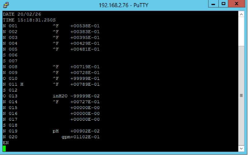

If anyone is up to a challenge, I have been working all day to figure out a good way to convert data retrieved from some legacy devices from ASCII format via SINT array to floating point. Putty returns the following;
My communication module returns each individual character as a SINT data type in an array (SINT[4000]). I need to pick out the 5 digits of data, apply the appropriate sign and exponent to create the floating point number. I have a few ways to do that but none of them are very pretty, because each digit is a separate SINT register. ControlLogix version 30 is the platform I'm using. Any good ideas out there? I hate working with ASCII data to begin with, but when it's reall SINT data to begin with it's even worse.

Sorry about the small screenshot. It was late in the day and I had to go to an appointment.
To clarify my situation, each character, including space, is returned as ASCII code in a single SINT in an array. The data shown here is actually 710 characters.
SO-- I have to capture each digit, rebuild it into an integer, apply the exponent and modify the sign if necessary. I can do this with ladder code but in all there are 110 data points I have to log so that's a lot of work for a PLC that has other jobs to do too. I find references to this problem in other places but they mostly explain how the ASCII/DINT conversion works which isn't applicable.

My comm module returns data in a 4000 element array of SINT format. There are no options for that. Each character in the string is an ASCII code in a single SINT element. There are 709 SINT elements in the example shown above. If I try to copy SINT elements into a string data type, I get an excessively long STRING type length and cannot extract the wanted characters (I really only need the 5 value digits). If I search the PLC forums there are numerous instances of this question without any good answers. I think I'm going to have to convert each character one by one and do conversion math to make it work.

I am using ProSoft MVI56-GEC generic ASCII module.

The character array ostensibly includes EOL characters, so there might be some sort of file structure the array can be converted to.

I thought I had it, and was using the copy COP object to move array data into a STRING tag and then use the MID instruction to remove the desired characters. This has the unfortunate effect of making the string tag length LEN 168645424! Atomic STRING tags are limited to 82 characters so I don't know how that doesn't fault the processor or something, but the COP instruction isn't meant to work with STRING data type anyway.
I have created a way to generate the floating point tags from the SINT[4000] array, but it isn't really pretty. As with my past experiences, I'll just declare that ASCII sucks, at least to me.

COP instruction sometimes you have to put length in from the string.len or really look at data to see what you are coping in that variable if coping from one data type to another. Its not straight forward as you see. When you copy to one different variable its inconsistent on what it copies.
