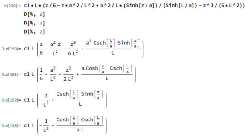

- Case 5 (θ''): My results are similar for the larger values of L/a but there is a discrepancy at smaller values. For L/a = 1, tabulated max is -0.14 and I get about half of this.

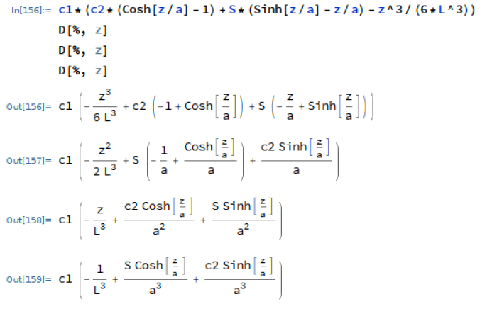

- Case 8 (θ'): Similar to above, my results tend to increasing discrepancy as L/a approaches zero.

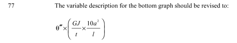

- Case 8 (θ'''): My results are out by a factor of 10 compared to the literature. Is it possible the latter is missing a factor of 10?

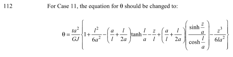

- Case 11 (θ''): I think there is an error in the formula for the second derivative.
The literature from AISC did have at least one mistake, in Case 3 (θ), the original values have been overwritten.

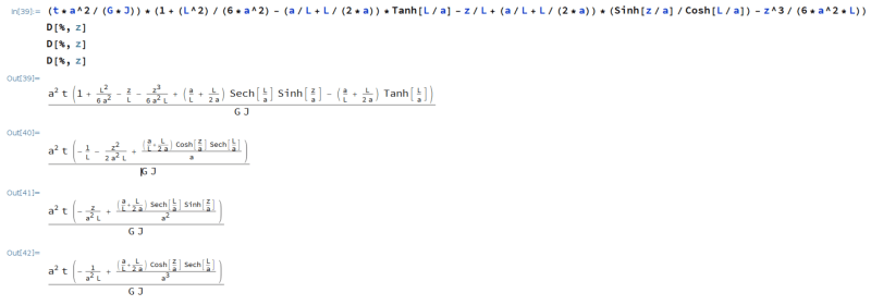

Definitely case 11 is incorrect, as you've proposed it should be a negative sign (output from Mathematica):-
Note you can simplify further to be in a similar form to the AISC equations by factoring the 'a' terms and recognising that sech=1/cosh.
I did a small writeup here

Case 8 derivatives also seems correct (the same as AISC versions), no factor of 10 in there sorry.
Case 5 derivatives also seem correct (the same as AISC versions)

- The subtle difference in Case 5 (θ'') and Case 8 (θ'): Who knows?
- The factor of difference in Case 8 (θ''') : The plot axis shows θ''' x (GJ/t x a^2/L) ... my suggestion was that it should be θ''' x (10GJ/t x a^2/L).

I did just note they have recently updated the errata for DG9.
This includes a revision to the original angle formula for case 11 to:-

For case 8 page 77 bottom graph the graph is actually now noted as being for:-
So you are right it is out by a factor of 10.

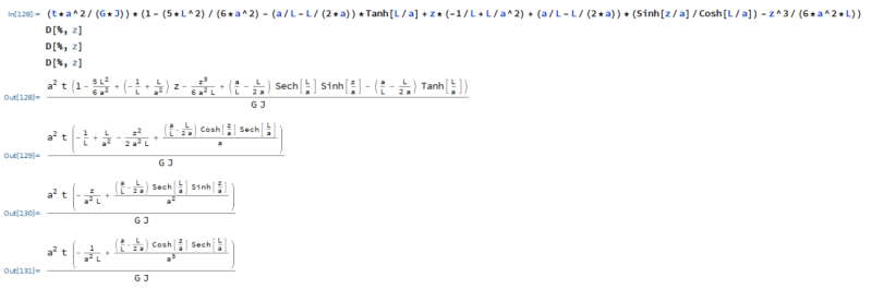

Updated derivatives for case 11, note subtle changes in 1st derivative and sign change in 2nd and 3rd derivatives compared to previous result:-
